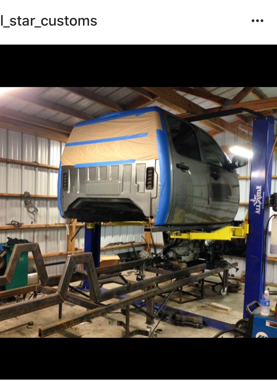

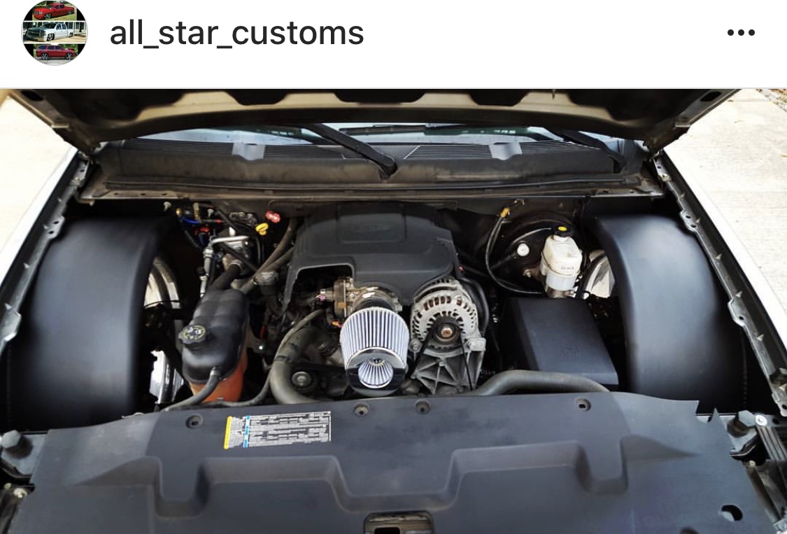

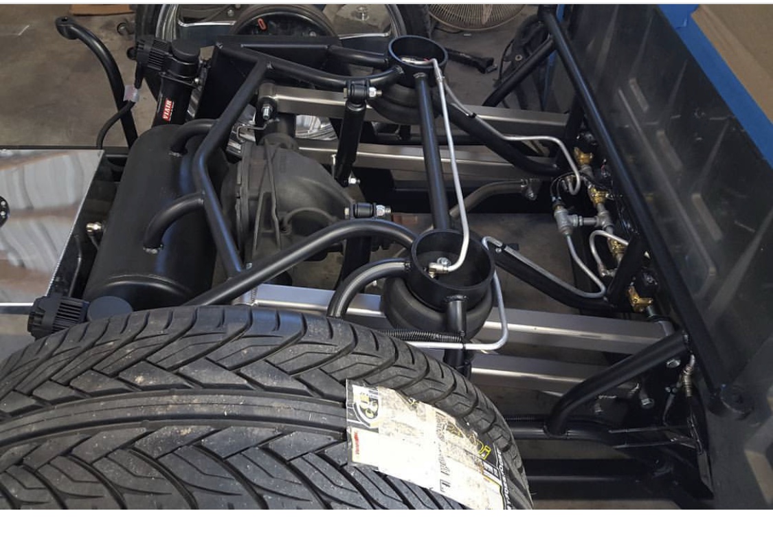

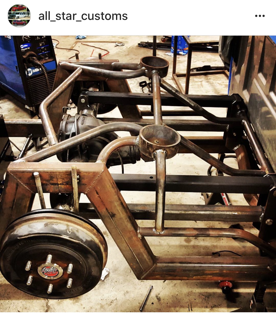

In a general sense yes they're similar. I believe lifting will be comparitively easy considering lowering usually involves modifying the frame and suspension components to a greater degree in order to get things to tuck. When you lift, the frame gets farther away from obstructions. My CC had a new frame built from the engine mounts back in order to lower the body on the frame as well as tuck the wheels and rear axle, plus the axle had to be narrowed. Also there's other things like tubs, remounting things under the hood to make room, etc. I know mine's an extreme example of a bagged suspension but it's also what most people are talking about when they say a bagged truck.

Rocketman...we're on the same page. Nice setup!! You put pictures to the words in my head. When lowering, you're repositioning the frame mounting points upward...effectively dropping the vehicle. When lifting, you're typically lowering the frame mounting points...effectively lifting the vehicle. Suspension movement will be reduced/increased based on the amount of travel available between frame/ground points.
