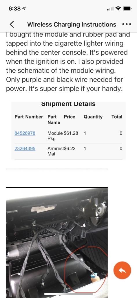

OP got in touch with me. I set him up with part numbers and instructions. He is all set
Can you post the part numbers and instructions?

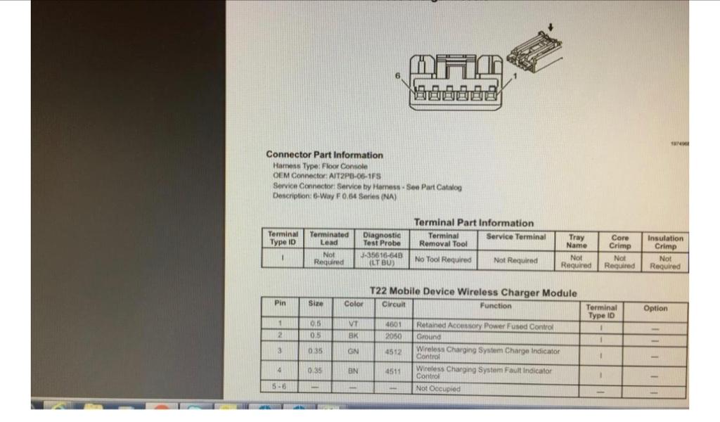

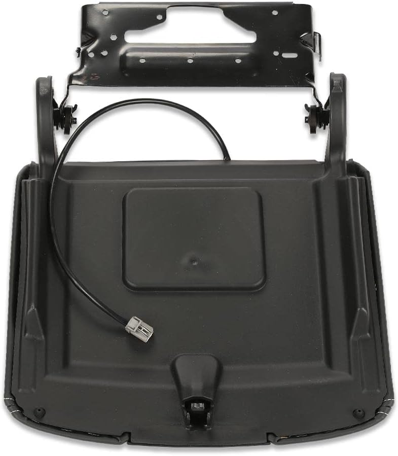

Kicking this back one up... leather ripped on our center console and found this replacement that comes with wireless built it. I just need to find a 3-way adapter to utlize the plug powering the cigarette lighter so it can power both the cigarette lighter and this wireless charger.
Has any done this and any idea what type of connect this is in case I can find or make one to be plug and play?

Look at Post #7 in this thread; the connector part number is in the pic.

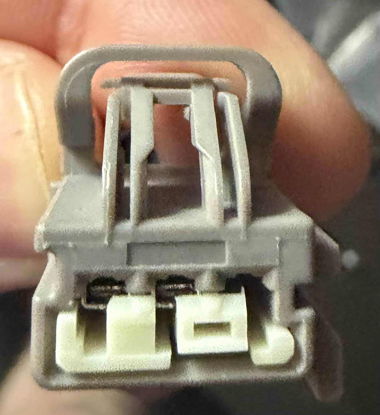

Here is a pic of the connector from this new replacement center console with wireless charger.
