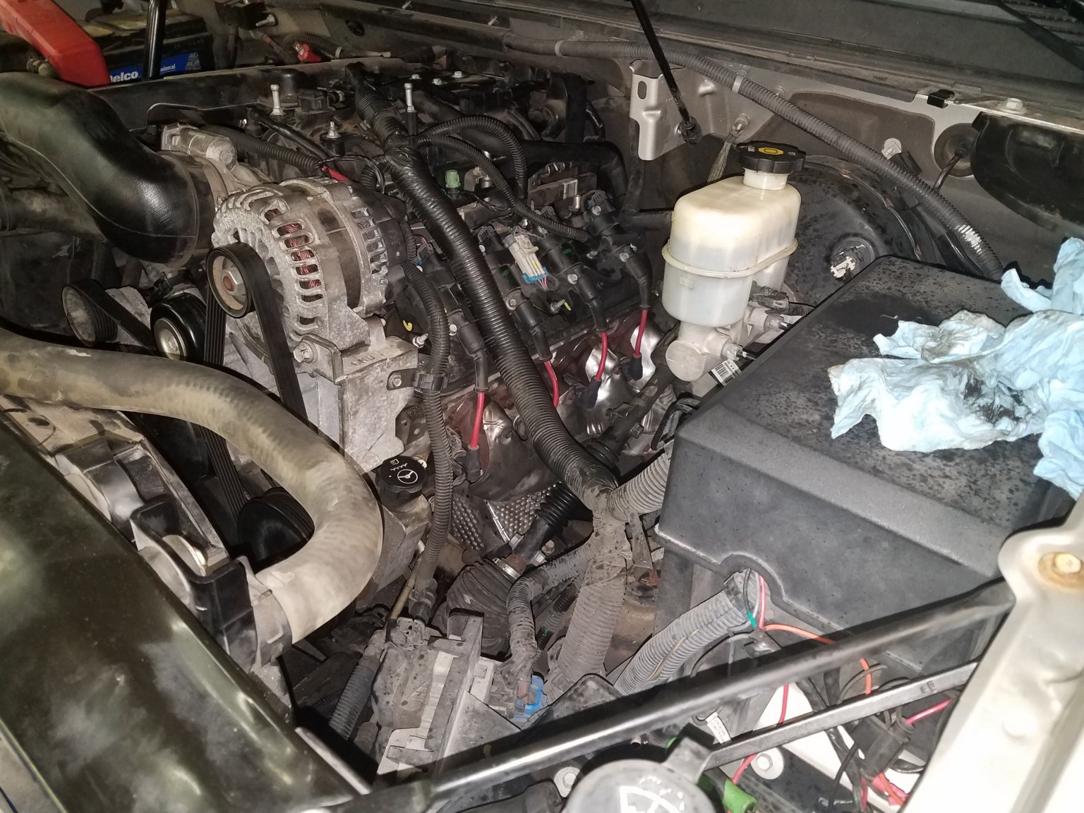

done for the night, got everything ready to go except doing fluids.

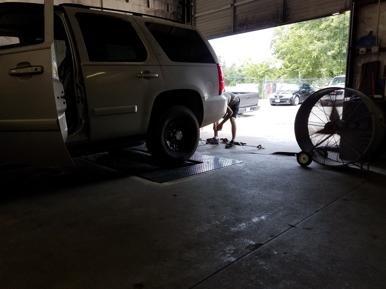

Tahoe is done and loaded back up on the trailer for its ride back to GA.
Picture of it on the dyno.
sfc_jones
sfc_jones
Feb 26, 2017
91
75
So it showed 272 HP and 293 Lbs of Torque at 90 mph because I have S rated tires on it and when he pushed it to 128 mph the tires got a nasty looking wrinkle to them and he let off fearing they would explode. I was moving pretty quick too when I seen it...I know that GM calls 320 HP at the crank but I thought I would get 300 HP at the wheel but I did accomplish the DOD/AFM delete. I am still happy with it. It wasn't like I was drag racing it or anything just wanted a few extra ponies out of it if I could.
