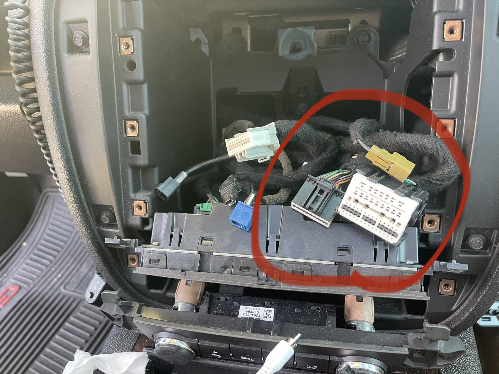

I have a bose Nav system in 2013 Yukon Denali XL. I'm planning to replace with Pioneer 8400NEX using Maestro RR. Does any one know if I need to HRN-RR-GM2 work or HRN-RR-GM5. Also for rear seat entertainment, I'm planning to add HRN-AV-GM5. Do I need anything else? Thanks in advance
According to Crutchfield site, that radio does not fit your veh. However, I just installed The Pioneer DMH-W4660NEX into my 2012 Tahoe and the GM2 harness was perfect. Your connections look exactly like what I just dealt with.
I would also recommend spending the extra 20 bucks and get USB aux port replacements and you can pop those 2 cig lighters out and make them USB ports.
26,374
51,833
The only reason Crutchfield says a lot of the HU’s don’t fit our trucks is because of the plastic cage that’s behind the stereo. You just need to cut some of it out with a Dremel or just grab it with some pliers and break it out if you have to. It’s not needed. There might also be a metal brace back there that needs to be removed. Otherwise you’re limited to the short chassis HU’s which eliminates most of them.
Gideon K
Apr 7, 2021
Thanks for the info! I'll order GM2. Hope the player fits. I'll also add that USB port thingy. Just saw a video. Seems pretty nice to have!
