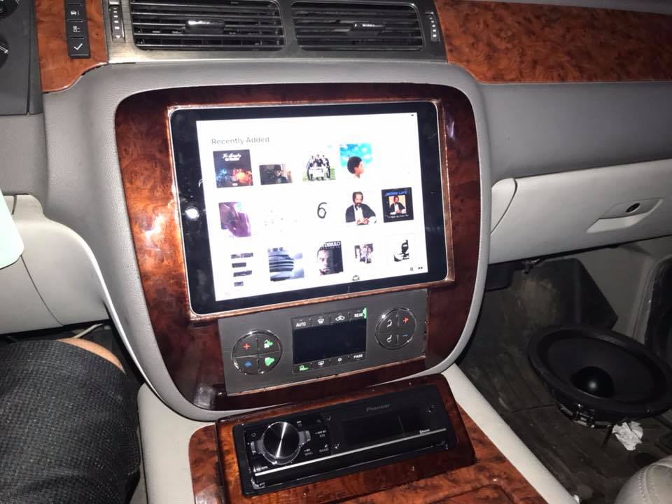

does your lightning plug have any give to it as to not break it off when you plug in and remove the iPad?

Hey sorry if I missed this detail but are you able to run dual zone with this setup?
No need for it to give. Never had an issue with it breaking. There was enough play so it wouldn't break

Nathan, first of all you did an awesome job on this install. I did one in my 04 Avalanche but I was able to mount the radio under it and move my ac controls to the overhead console.
I just bought a different car (02 deville), and I'm going to glass one into the dash of this one too. I'm going to have to put my radio in the glove box and do a faceplate extension exactly like you did. I'm wanting to go with the sony gs-620bt (also to answer the post about songpal or app remote-songpal is a newer version of app remote that works with the newer units). Anyway, how the hell did you extend the faceplate like that???? You bought some kind of plugs or did you have to solder all those wires? I need help man! Lol
soldered wires from one end to the other. Being very careful during install...

Just saw this thread...
I just wanted to say that I did the same thing to a detachable face CD player way back in the day.
I used telephone line to attach them together and mounted the face plate in my drivers sun visor and the main unit in the dash. The only thing visible in the dash was the slot for the CD.
That was along time ago before Ipads and even before cell phones were common place. Maybe kinda hokey by today's standards but back them it was pretty slick to flip down the visor and adjust the stereo.
