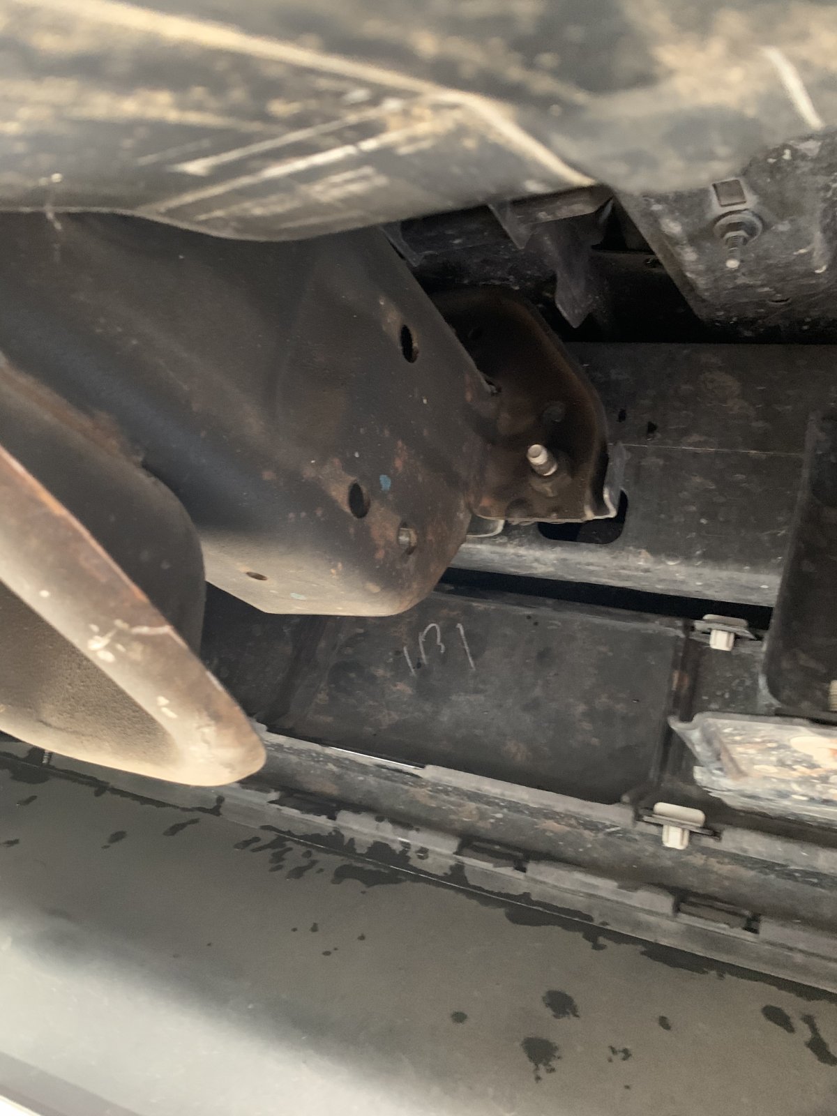

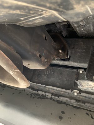

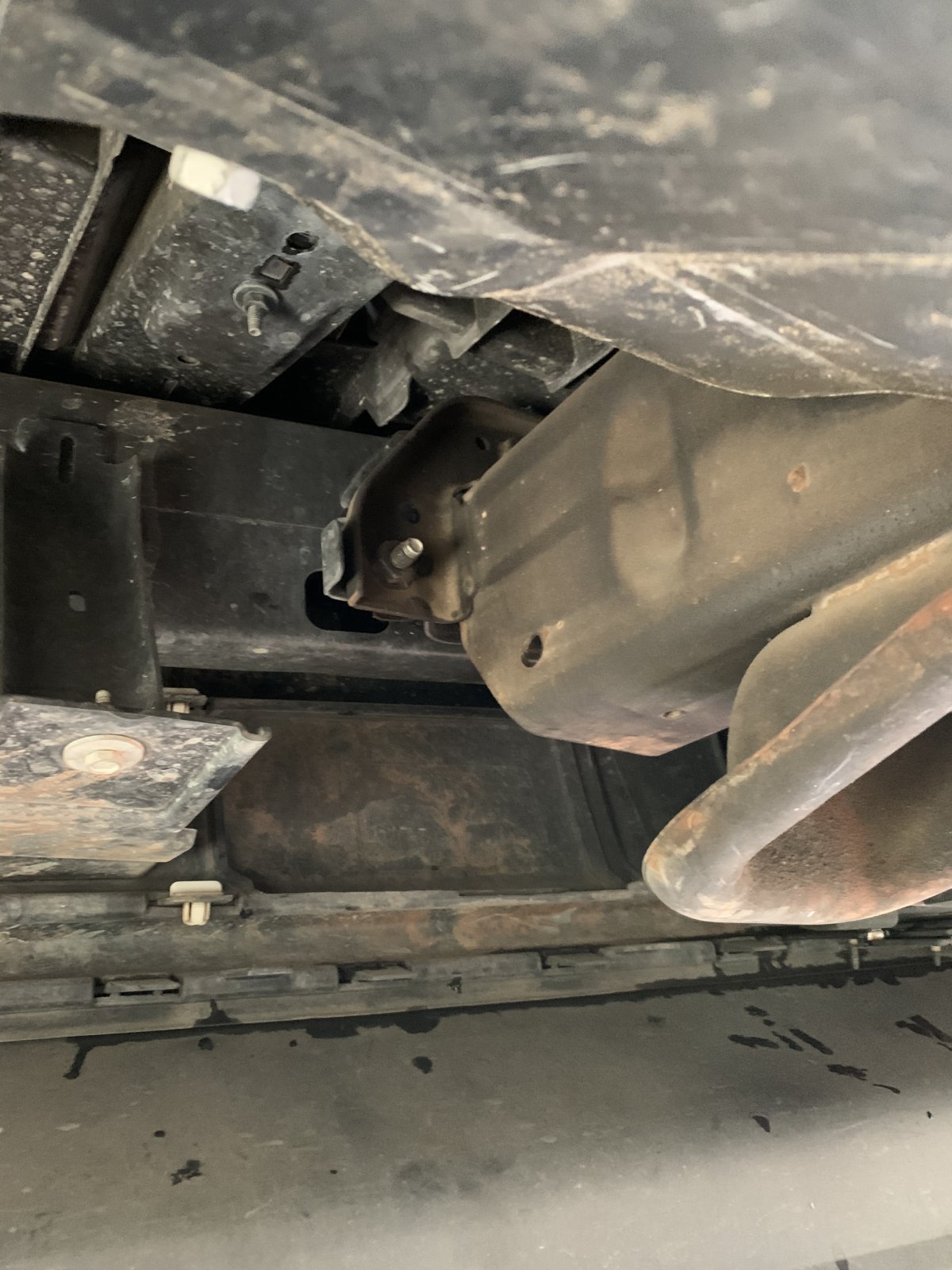

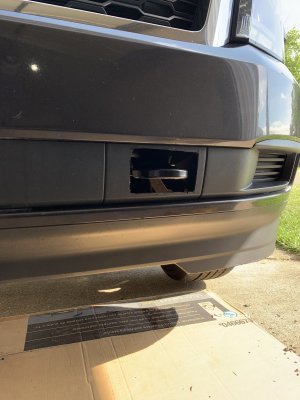

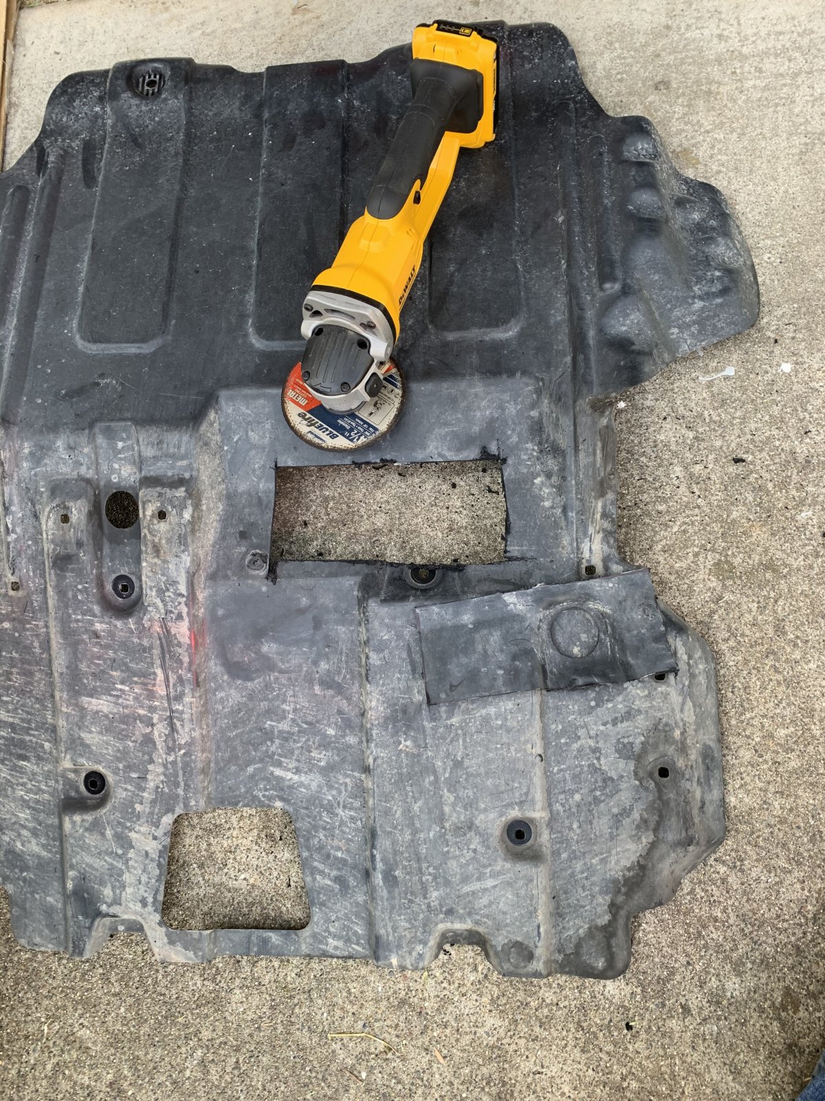

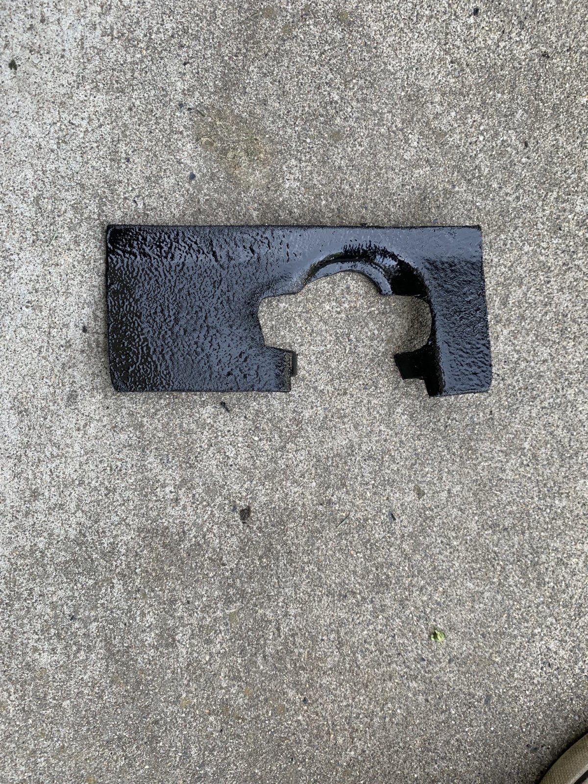

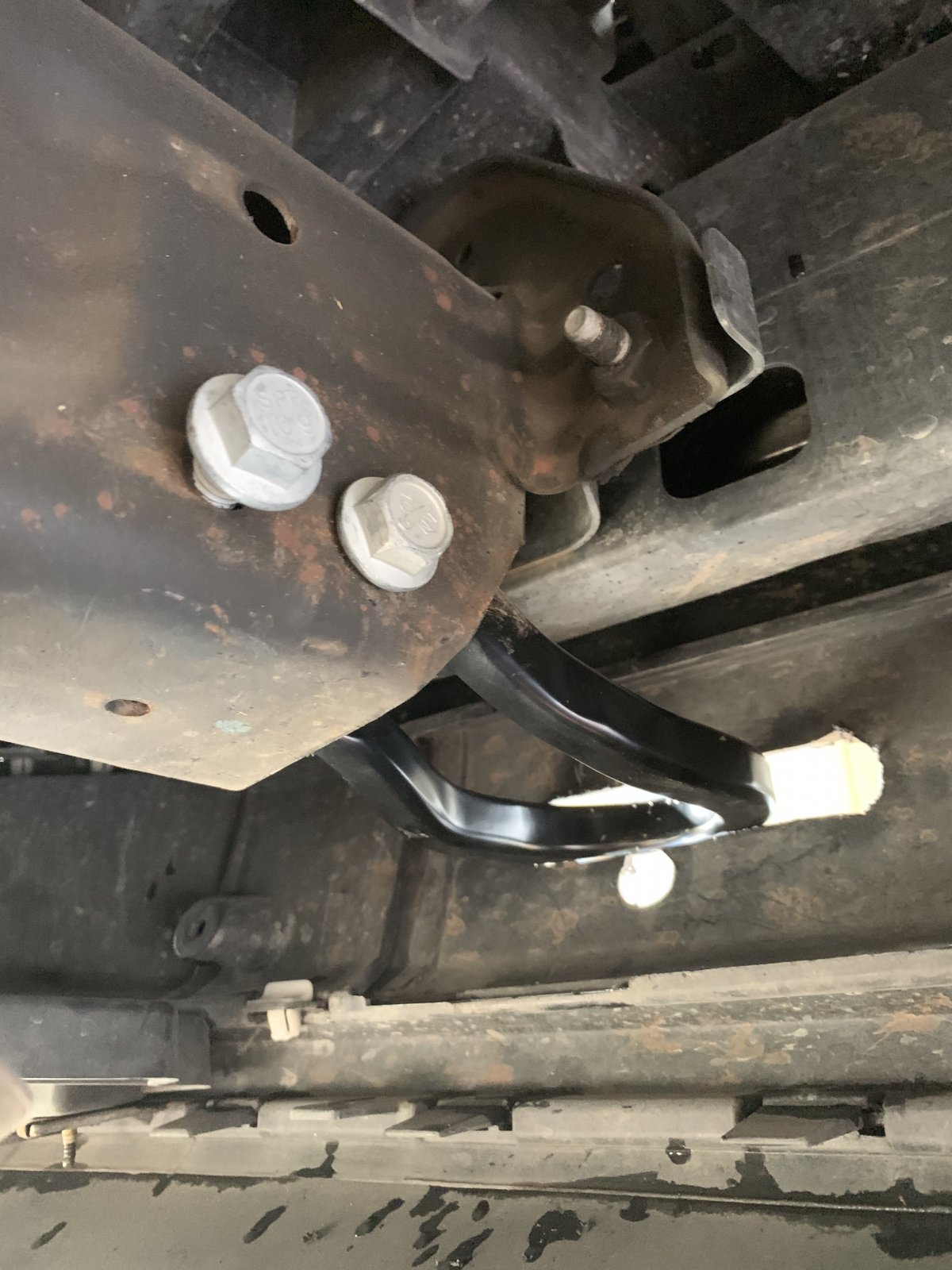

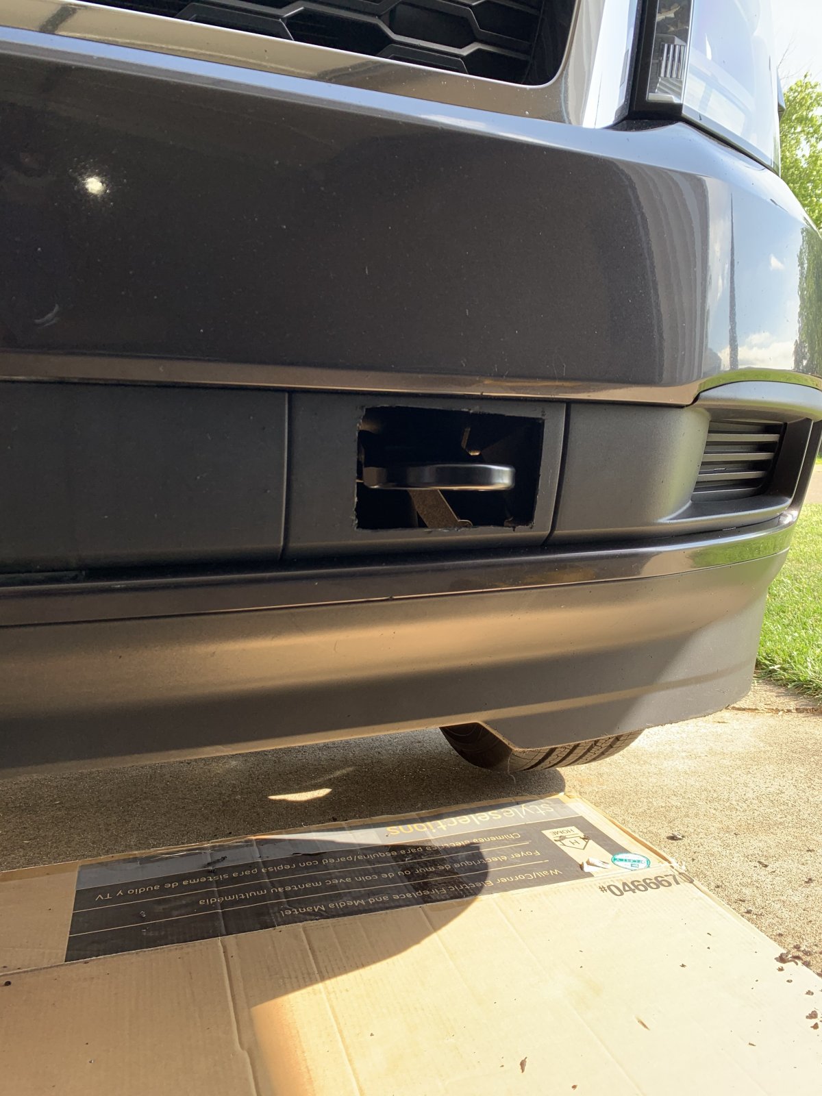

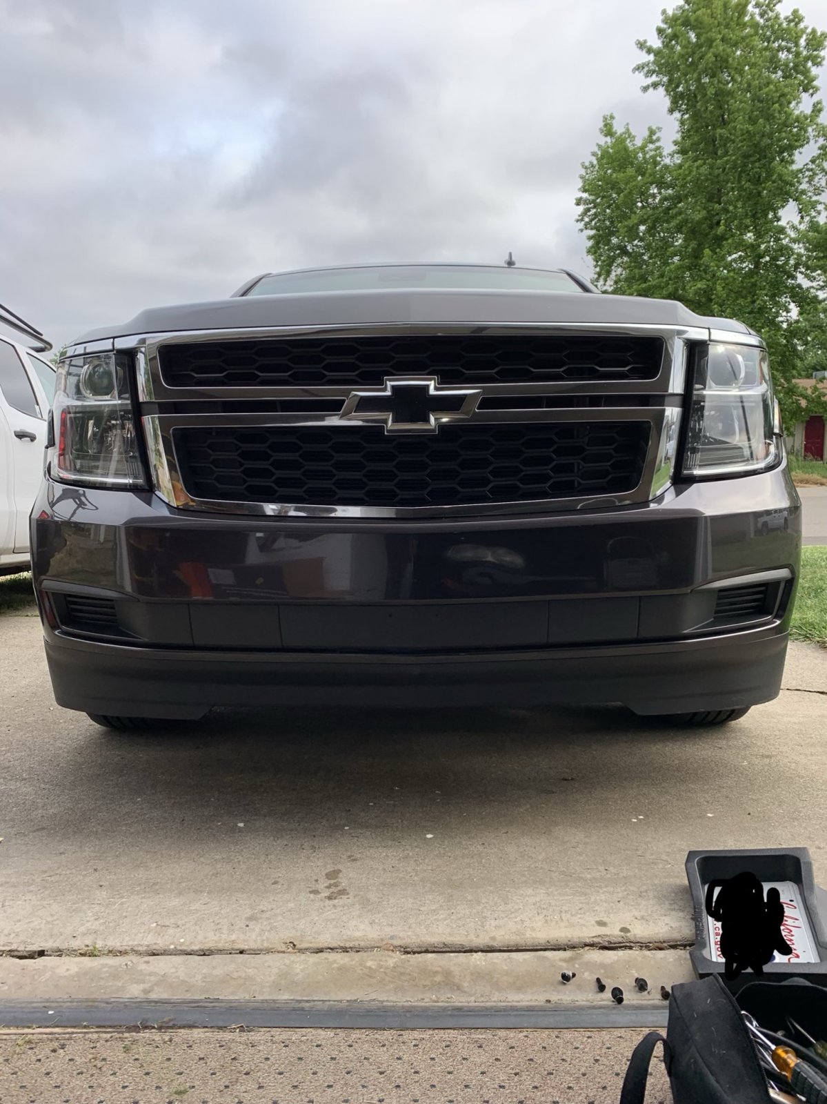

I put just one for now to keep me out of trouble. I’ll eventually buy the correct plastic bumper piece that has the provisions and add the other hook. I went full ghetto and butchered a cover piece from my stock plastic skid plate where the drain plug would be because it’s recessed a bit. Pretty easy job. I’m not sure why Chevy wouldn’t put something on the front of the truck for recovery on all 4wd’s???

Clean install! ~ I have been wanting to do this but the factory hooks look like a PITA to install.

It's pretty straight forward. I ended up just buying the front trim piece with the hook openings, but it's 2 bolts per hook maybe 20 min job total on the 15'+s.

2 bolts for tow hooks since 1973... right in the ends of the frame. 01-06 and 07-14 the holes in the bumper are there and 15 up if you don’t have them factory you need to notch or buy a new piece. Just fyi-ing
