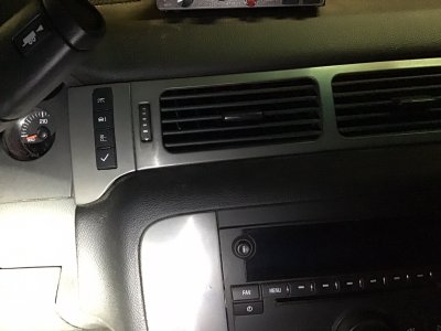

They have them on Amazon. The wiring harness is already there. You can either cut out a spot with a dremel and use a hot glue gun or order the panal from chevy.

There are two/three different ways. The panel with the opening for it goes all the way across the dash on the passenger side. Sometimes you can find the last separate piece on ebay, but factory it is "welded" together.
Also, like others said, you can cut the hole. The switch/module itself is pretty inexpensive, like $20 or so. The plug should just sit unused behind the trim panel, it just plugs in. The easiest upgrade to do really.

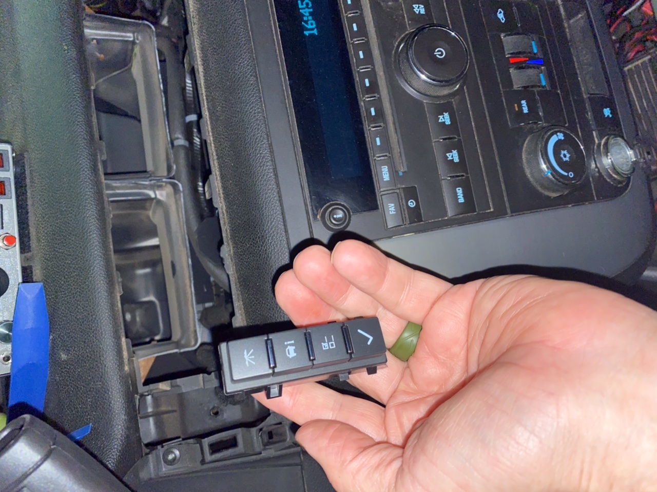

Is the wiring harness on the right side of the steering wheel in a 2012 Tahoe PPV?
Yes. Behind the trim in that cavity visible just behind the DIC switch I’m holding.
