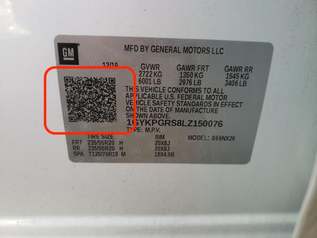

If they are telling you that you don't have it, you can always pull up your RPO codes (see attachment) and look for "KSG" which is the RPO Code:
KSG
  • Adaptive Cruise Control - Advanced
  • Adaptive Cruise Control - Camera
  • Cruise control, adaptive, full range
  • Cruise control, adaptive, full-speed range
  • CRUISE CONTROL AUTOMATIC, ADAPTIVE WITH STOP/GO
If it''s there, tell them to fix it!
