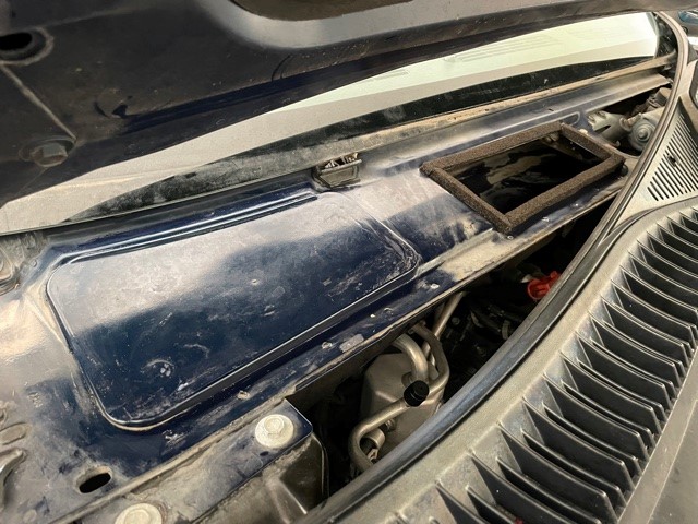

i dont recall the floor being wet in my case, not many chances for rain here in Vegas. but i do think there is a leak being the fan switch has fried at least twice now.
this panel that needs to be sealed, anymore insight on where this is? i cant remember where i saw info about this. When looking under the cowl, i see a rectangular opening that looks like it would go towards the duct for blower motor. but there isnt anything to seal. when looking from under the dash, i see there is a foam gasket for something, but couldnt really see what that is for. i was a smart one and started this project as the sun went down so lighting is not working in my favor be any means
YukonGTmaster
2 Door w/ Barn Doors Club
Mar 18, 2021
601
1,273
The rectangular “blanking” panel is located under the passenger side of the defrost grill by the windshield wiper. Left on the picture below. This panel had sealant around it that was cracked and allowed water to leak into the blower duct located directly underneath. I laid a heavy bead of silicone all around it, and all was good.
awesome, thank you.
i will grab some silicone and take a look at it this afternoon.
