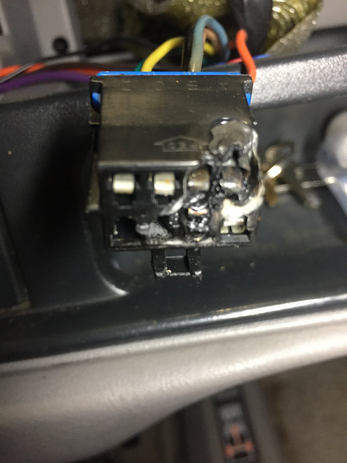

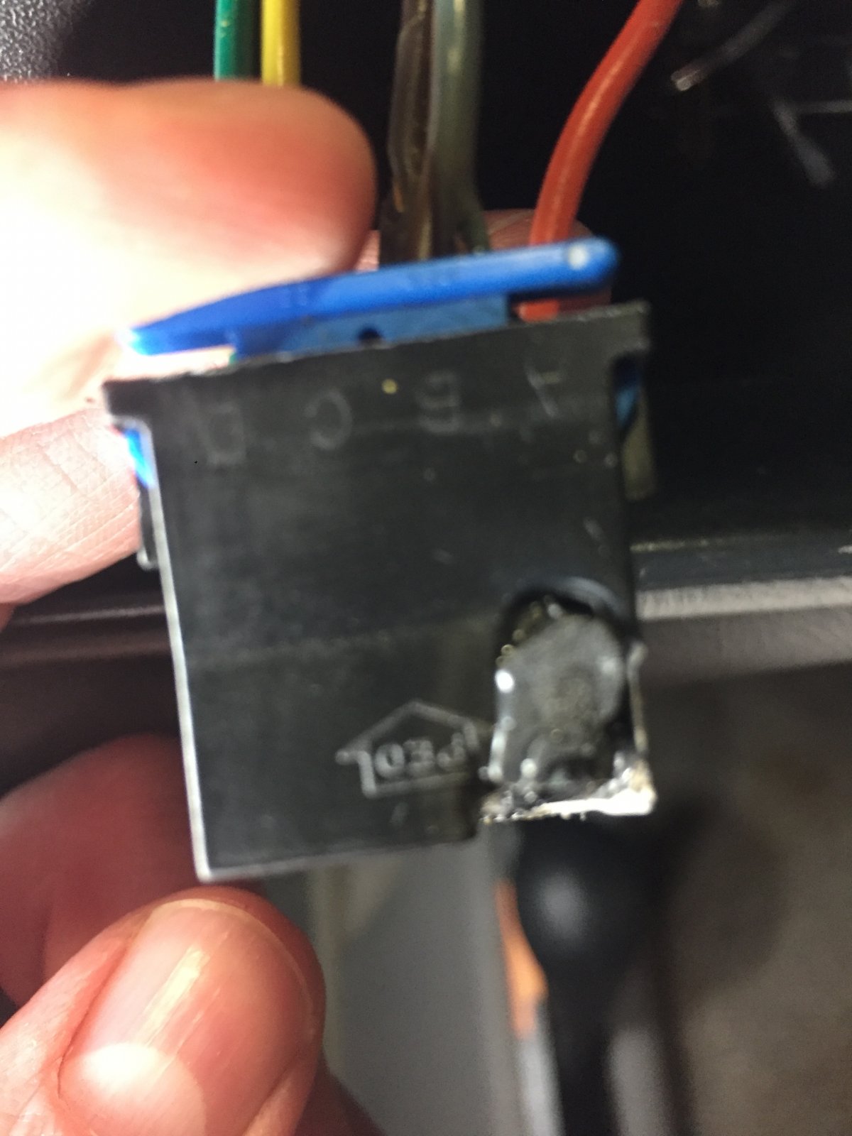

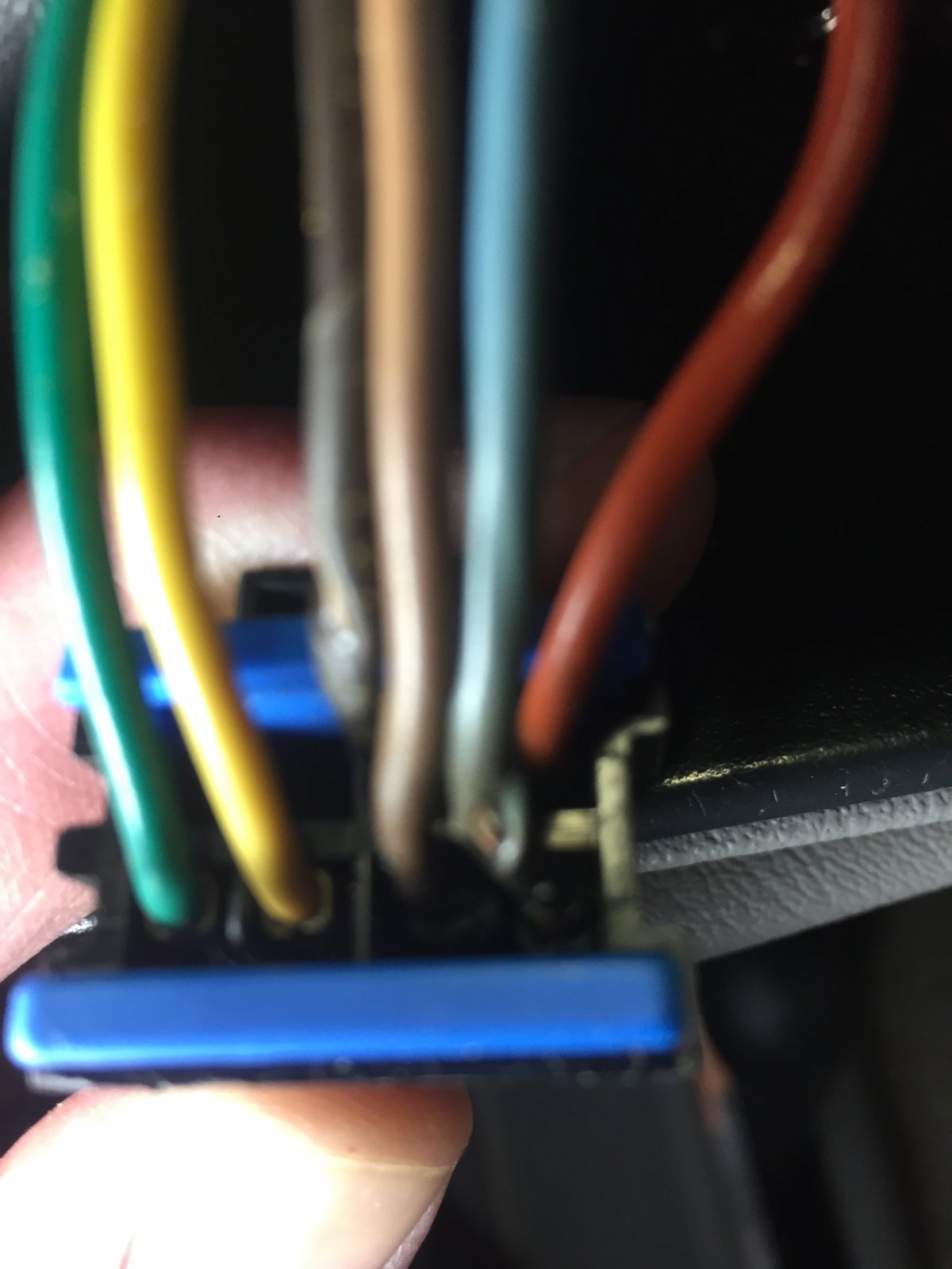

When it quits working, does the fan completely stop, and the illumination goes black? I would double check the plastic connector behind the climate control module. Look for corrosion, loose pins, chafed wires.
I had intermittent climate control, until it died. It ended up being water leaking down through the defrost grills at the windshield and pooling in the heater duct, which fried the connector at my climate control. The GM dealer sells a harness that you just cut off the old wires and connector, and butt splice the new one in.
