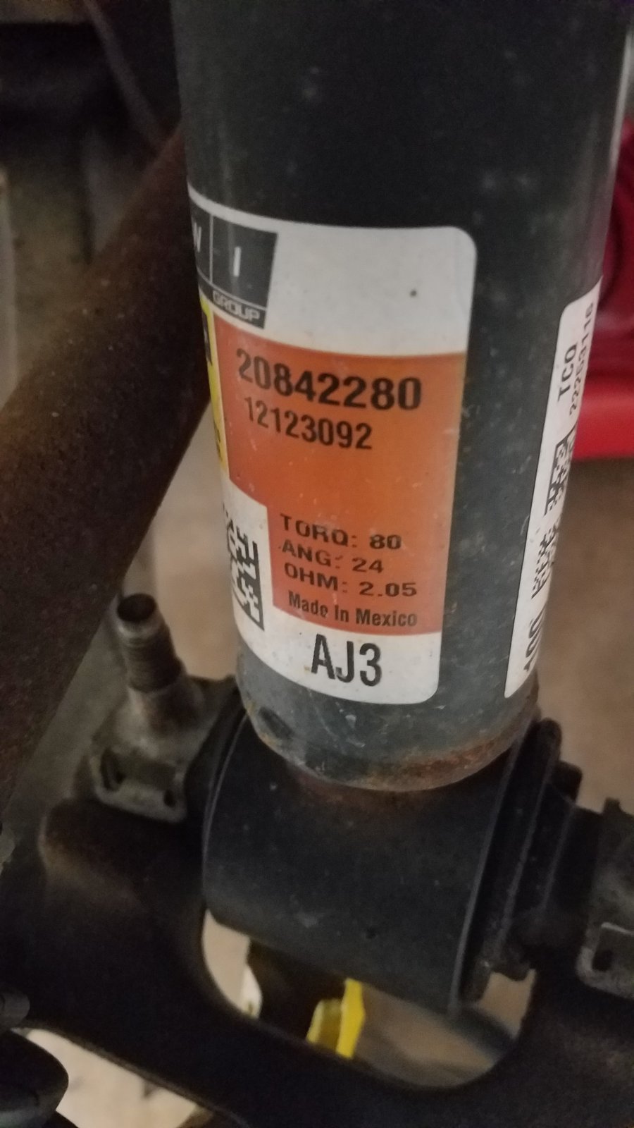

There is a permanent label on each shock that has the part number. I snapped a pic of the labels on both of my trucks, front and rear, and ordered that way. There were different part numbers for the 2007 and 2012 vintages. Perfect fit in both cases.

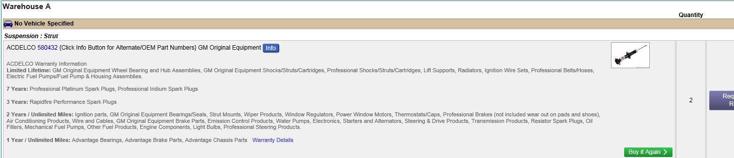

580-1093 is 19368461
580-434 should be 19420493, 90% sure.
Note, especially for the rear shocks, both numbers are printed on the box, it's the same part.

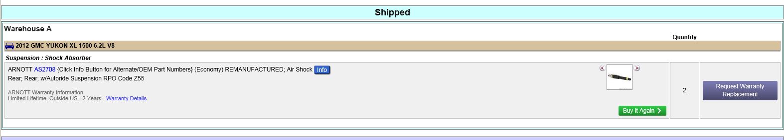

these are the ones I used on my 2012, you can replace just the shock-strut portion of the front that is the only part that wears out. lifetime warranty from rockauto

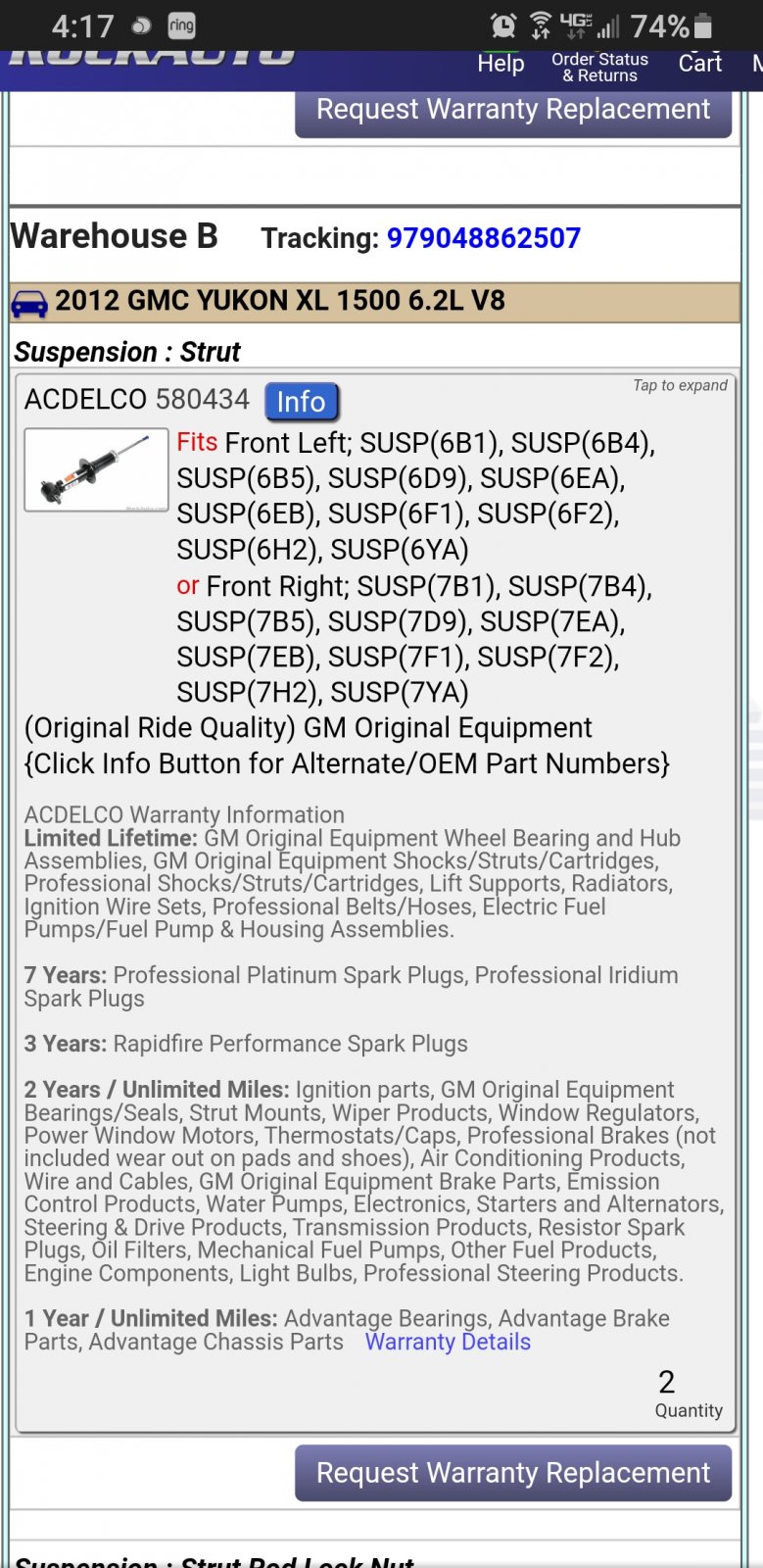

My 2012 took the 580-434 struts (different suspension code)

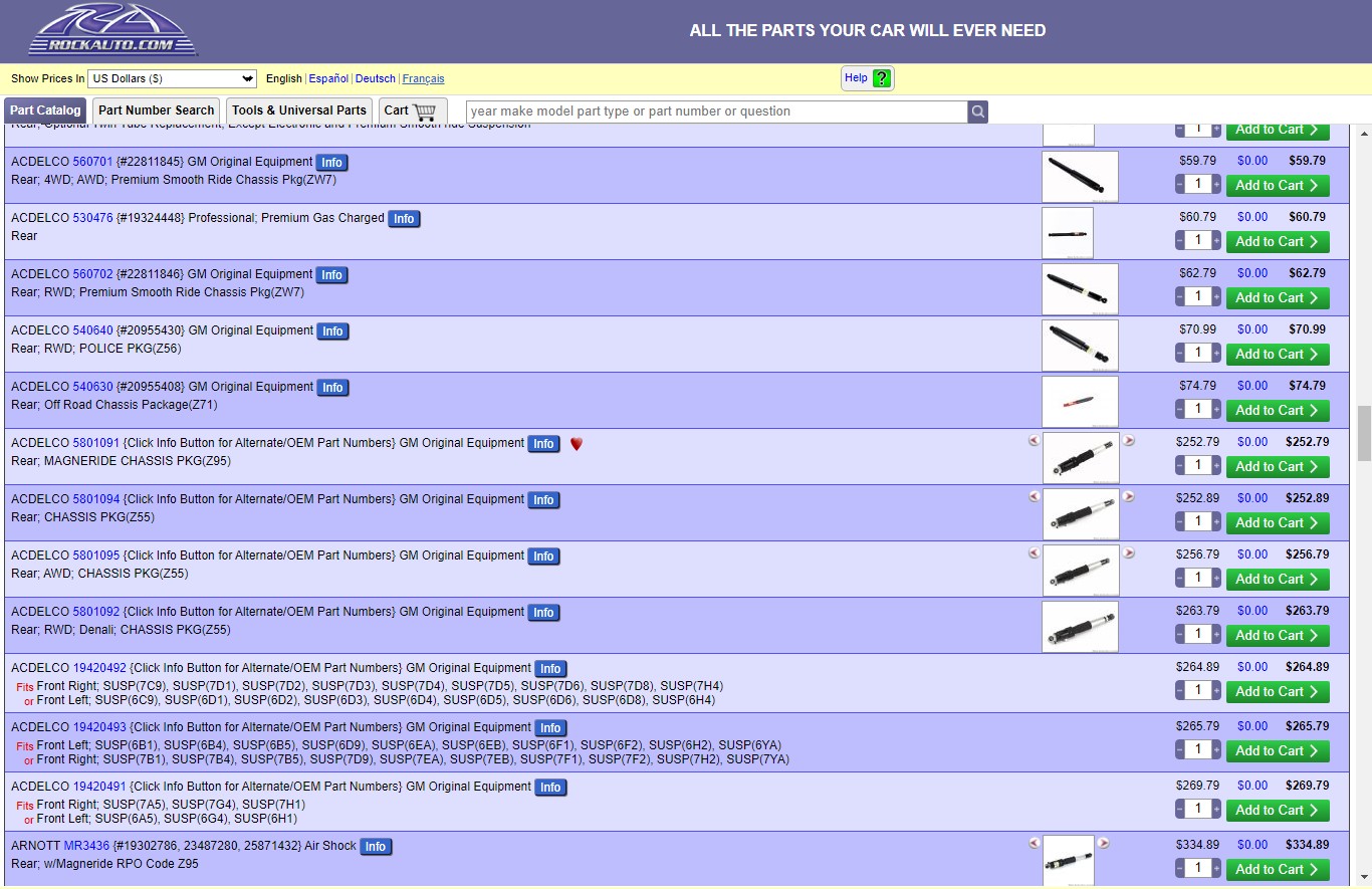

i didn't even go by that I got the number off the strut and cross referenced it on the rockauto website and picked one. it matched up with about 20 struts I don't think it makes any difference as you can see in your photo 1 strut matches up to 20 codes (technically 10 codes left/right). it's ridiculous
yeah when I searched for new OE shocks I couldn't find anything cross referencing the numbers that were on mine, so I had to go by the suspension code 6F1/7F120210703_161833.jpg
