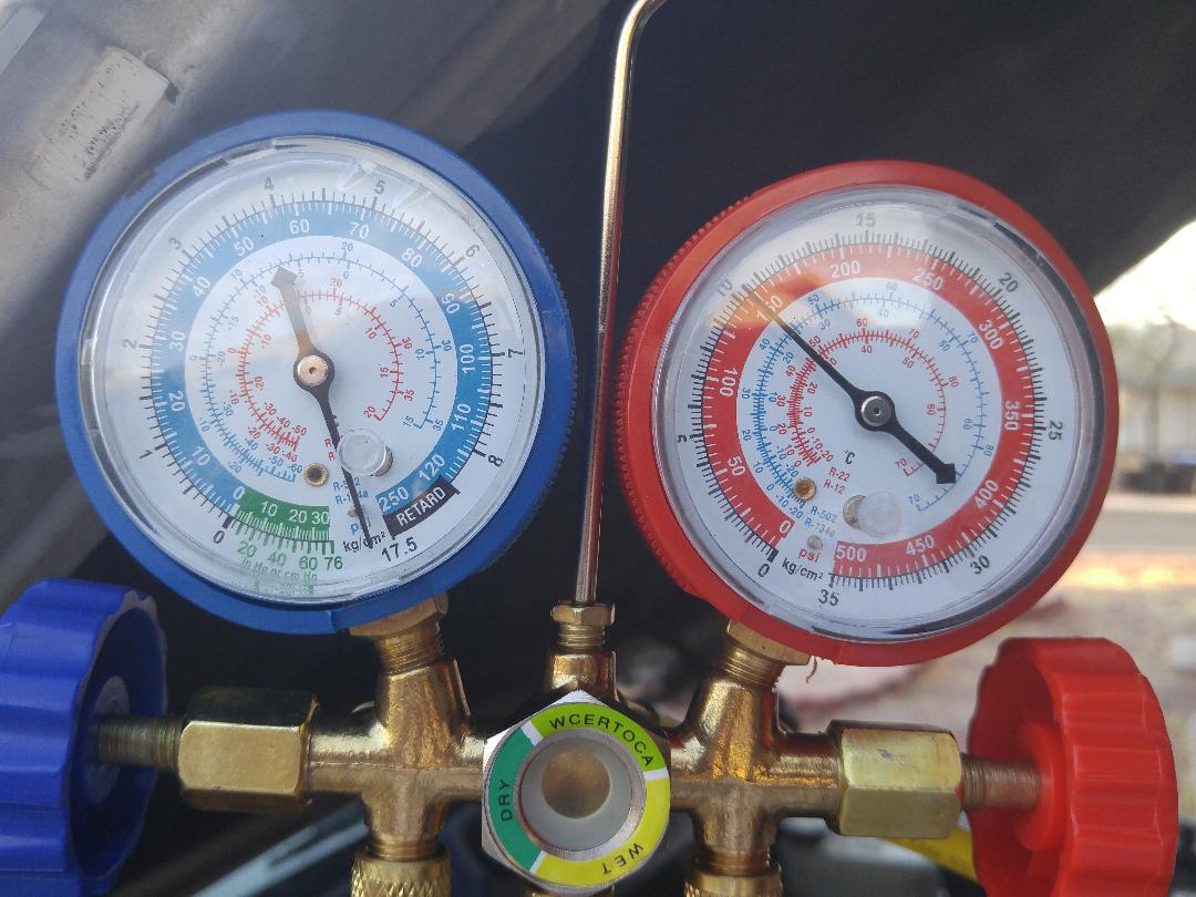

Anyway...I took a static reading tonite. Valves double checked closed. 100+ degrees ambient temp.
As you can see. The low side reading is pegged. WTH?

Im assuming when you say static pressure, the reading was taken with compressor disengaged. If so then at 100deg ambient temp the pressure for R134a would be right around 124PSI. Remember the Pressure is directly related to temperature with refrigerant. I would definitely get the truck to someone that knows what they are doing instead of this last guy "thinks it may be the PCM"? Instead of thinking all he had to do was check for the control signal coming from the PCM.
I suspect the cause of your "shortcycling" is actually hi pressure cutoff on the high side. This can be verified with gauges. You likely have a restriction and id be willing to bet with all the pumping down of the system after repairs that you sucked a bunch of crap out of drier into the orifice tube. Replace the orifice tube!
I literally just fixed this problem yesterday on my 03 Tahoe after having a compressor pulley bearing failure so I just replaced the whole compressor and got your symptoms. Orifice tube was plugged up with some grayish crud causing a restriction. Likely the original orifice tube! My High side would get up to 500psi and enable the popoff valve at the compressor and vent r134a.
And order up a ****** clone of the tech 2! Mine has saved me so many times it isnt funny. (I have two 03 tahoes and a 05 Yukon Denali). It has paid for itself so many times over.

You definitely need a different mechanic.Hot wiring the compressor lol.Sounds like an orifice tube to me also-curious if its crude or packed with metal shavings??You also need to fix the leak if its not leaking from evap you should be albe to detect dye even with a week of driving with the uv light.I have seen large leaks from evap with uv light from the drain hole.
