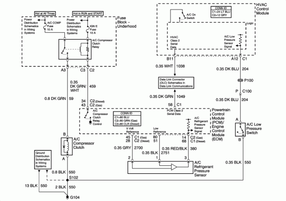

Do you have access to a decent scanner to tell what state the low and high pressure switches are at? The compressor clutch relay is GROUND SEEKING. The PCM provides that ground when conditions are met. The IGN E fuse (10a) provides 12v to the clutch RELAY COIL. The AC clutch itself is BOTH ground and 12v seeking. The 12v is provided by AC COMP fuse (10a) and that 12v has to pass through the closed Compressor clutch relay. The ground itself to the compressor clutch is provided by the HVAC control module BUT the ground has to be able to pass through the low pressure which will be opened up if refrigerant pressure is much lower than 30psi or so.
Quick and dirty is stick a set of refrigerant gauges on the hi and low side. The pressures should be roughly the same which is what happens when any a/c system is off. Id be interested in what pressures you read on yours. Common mistake after servicing an A/C system is not to make sure the valves in the schrader valves are tight, esspecially on the low side. A hose and gauge set can loosen the low side easily. I also recommend replacing the valves any time the system need to be evacuated, pumped down and recharged. Its cheap insurance.

Do you have access to a decent scanner to tell what state the low and high pressure switches are at? The compressor clutch relay is GROUND SEEKING. The PCM provides that ground when conditions are met. The IGN E fuse (10a) provides 12v to the clutch RELAY. The AC clutch itself is BOTH ground and 12v seeking. The 12v is provided by AC COMP fuse (10a) and that 12v has to pass through the closed Compressor clutch relay. The ground itself to the compressor clutch is provided by the HVAC control module BUT the ground has to be able to pass through the low pressure which will be opened up if refrigerant pressure is much lower than 30psi or so.
