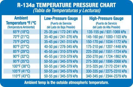

Sweating accumulator only tells so much. In your neck of the woods the dew point may be 65 degrees because of the high humidity. At that point at least you know there is Freon in it and the compressor is doing something.
Now take me in Phoenix today with 110 and dew point of 25 degrees at 5% humidity......a glass if ice cubes with water at 31 degrees won’t sweat a drop.
Need to know the pressures, high and low then go from there.

Here’s a charts but it all depends on temp, humidity and elevation. Now does your ac work temporarily and then quits? I wonder if you have a clearance issue as in the air gap between your clutch and coil is too great. When it heat up the metal expands and there’s too much of of an air gap for the coil to engage the clutch.

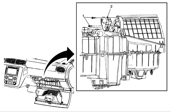

I am getting B0228-61 - for the life of me do you know where the recirculate actuator is on an ‘08 Tahoe? Is it underneath the passenger airbag by chance? I can only find the passenger and driver blend door actuators and they work fine.
21,296
30,248
Yes, it's near the passenger actuator and under the airbag, it is mounted on the side, facing the driver's side. Let me find a pic or diagram...
There you go!
Bowtied
Aug 4, 2020
17
The Lonestar State
There you go!
Dude thanks so much for this! Now I know where it is - is there any way I can access it via lowering the glovebox like on the left diagram or do I have to take the airbag out and work from there? I just got that airbag swapped from the recall at the dealer recently, go figure.*
Also, does your manual show a part number? I pulled 2 actuators from a junkyard they let me have for free, one of the ones I picked up looks real similar to that (but it could be the climate passenger, not sure.)
21,296
30,248
Yes, you can get at it through the glove box. These parts numbers are both printed on the box, sometimes one or the other is less expensive but you get the same thing.
ACDelco = 15-72971, GM OE = 89018365
