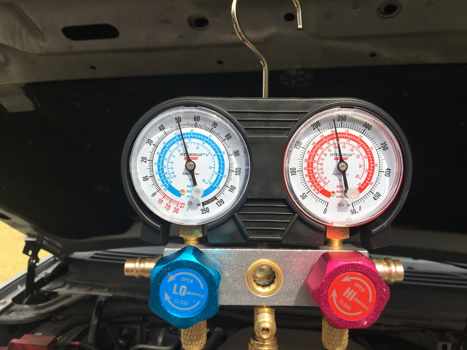

Just had the system evacuated, orifice tube replaced, sucked down and filled to spec as I was experiencing the same problems before I did. Pic of gauges in 98 degree heat. Problem only happens on long trips.

Long trips makes sense. Air doesn't have *that* much moisture in it and it'll take a bit to plug it up with ice such that you notice airflow problems.
Under what conditions were you measuring those pressures? Fan speed, ambient temp, RPM, vent temps (use a meat thermometer not infrared) and whether or not you're experiencing the icing issue
