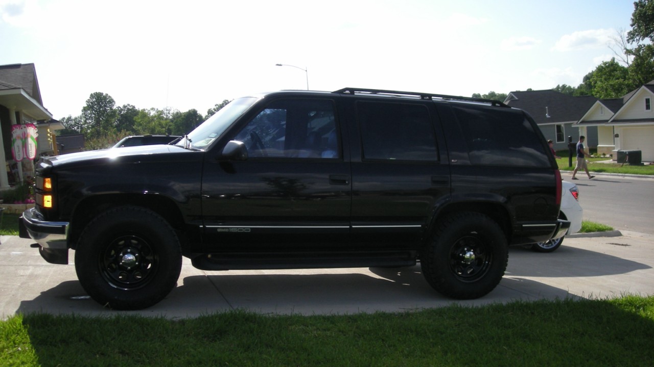

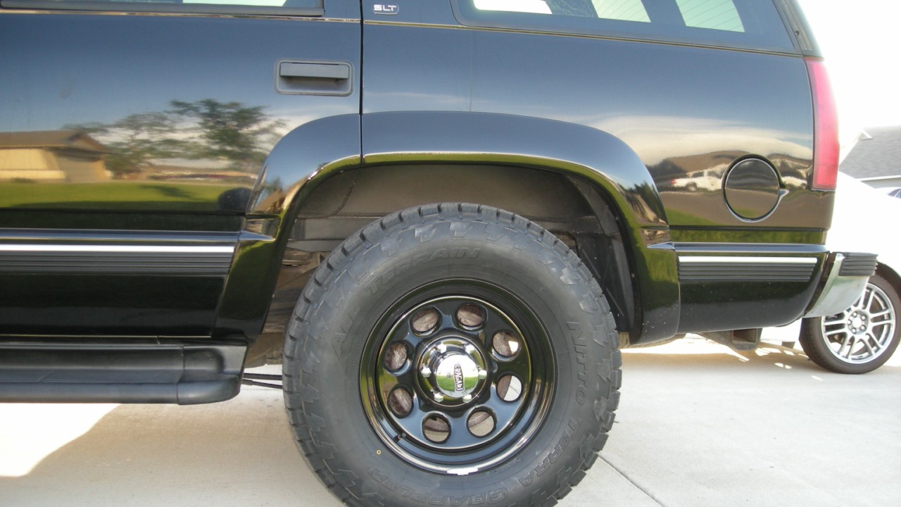

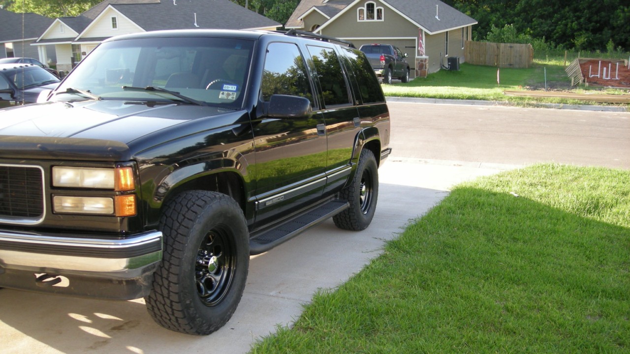

Got the tires and wheels installed today and put the rear fender flares back on. I think they came out ok, considering it's my first time to work with plastic and only my second time to paint anything.
I'm definitely going to have to crank the keys soon. I'm rubbing over very small bumps and at full lock on the lower fenderwells. That's the reason the front flares aren't installed, since I didn't want to f up the new paint.
Here ya go, lemme know what you guys think.
Side Profile:
A pic of the flare and wheel:
An angle from the front:

Everything turned out pretty good man. Flares look really nice! Wheels look awesome. Good stuff.

@Devious_Tahoe96:
Those should work fine without touching the keys. That's what...a 265 or something? These tires are like 32.7" , so they're almost 33's. I think they would have fit better with the stock backspacing, but since I went with 4.5" backspacing on an 8" rim, they stick out past the fender flares by a couple inches in front and were rubbing really bad if I went over any bumps without cranking.
I did end up cranking the keys up in the front for a 2" lift and it solved all the rubbing issues. It does ride a tad rough, but nothing that's going to jar your fillings lose. It made the truck handle better in my opinion instead of it leaning way over in every turn. When I get new shocks, it will probably help the ride as well because I have no idea how old these are.
