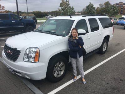

My Wife and the Yukon.

Congrats. I have a 2010 Denali. 57K, 6.2, AWD, ZERO problems.
My only complaint - Nav sucks big time - 10 years behind Garmin.
