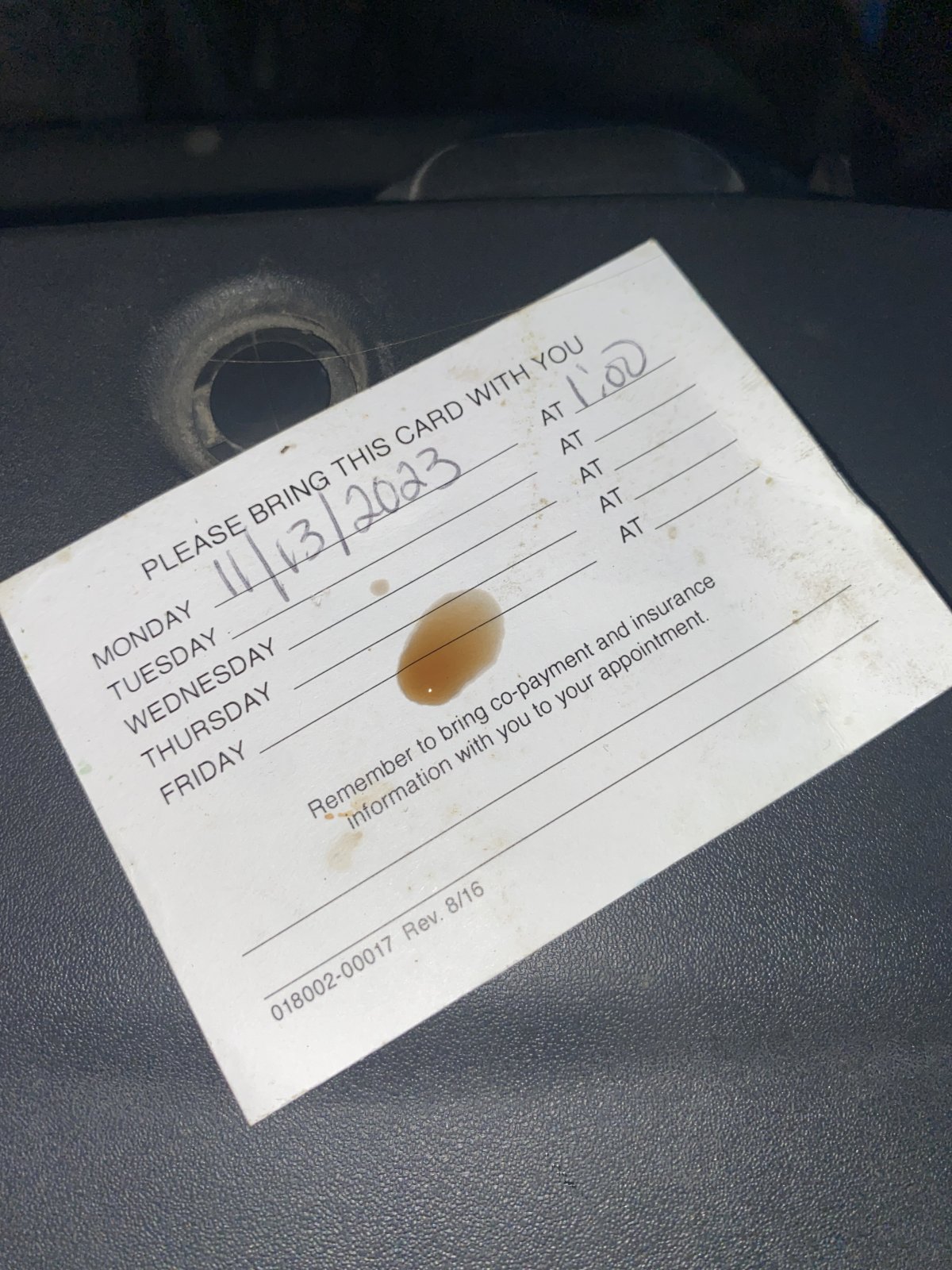

I have a slight pop when turning to the right now… I was told a few months ago my power steering pump is getting weak. Is it getting worse? My steering still feels pretty effortless. But definitely has a slight groan when turning. More noticeable at idle.

Is there any where i can look for worn or broken parts? I see the steering shaft here under the hood everything looks ok upon first glance

Time for a change I’d say
