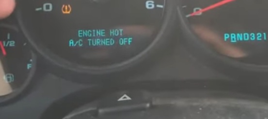

I posted what the dash said when truck overheated which is why I thought it was related to the overheat. I'll have mu mechanic check out what you mentioned as I've already checked the easy stuff with no luck . Thanks !
It was winter so I didn't have the AC on when it did this **
