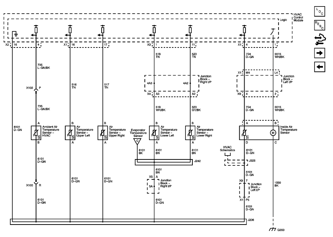

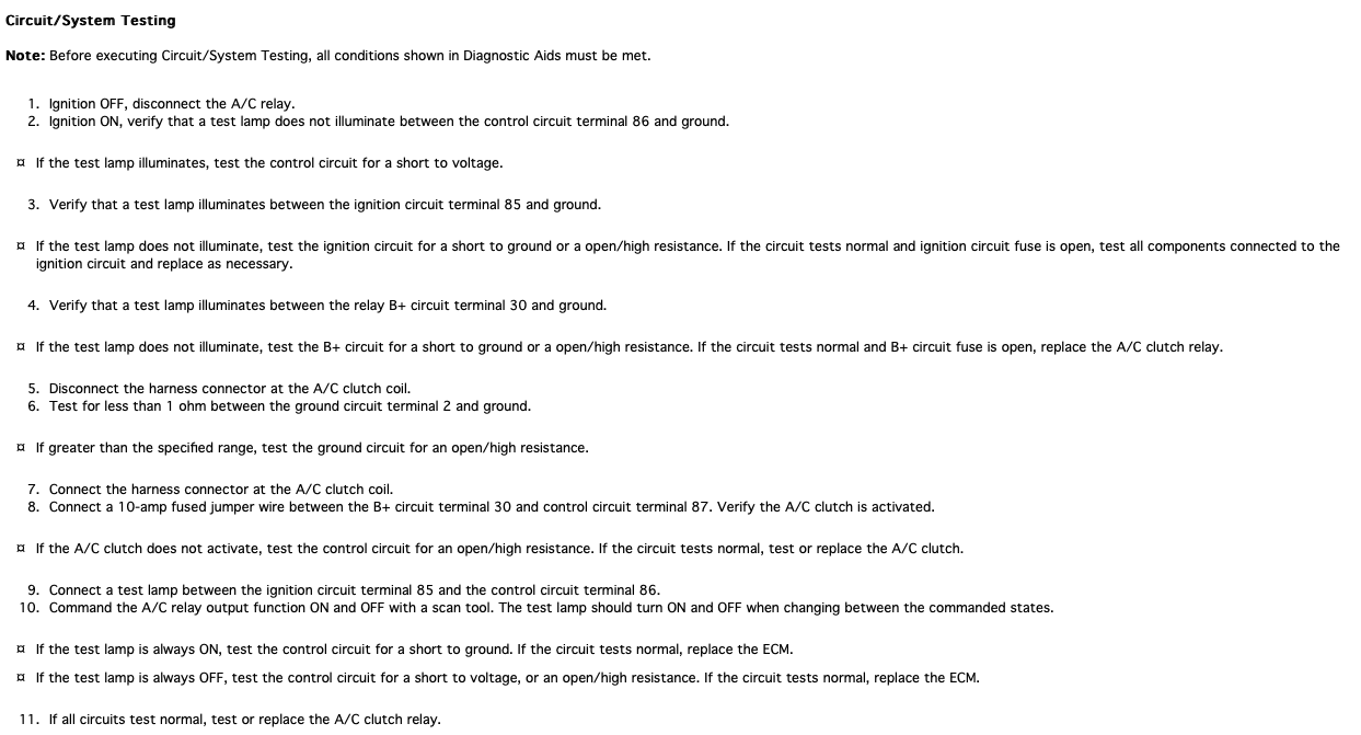

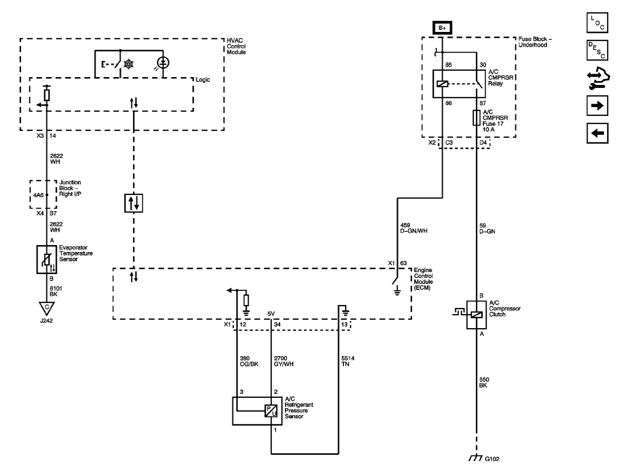

Here's a couple of schematics for the system. Since you already replaced the pressure sensor, I would be inclined to suspect that either the compressor relay isn't staying closed or one of the temperature sensors has failed. If you have access to a Tech 2 scanner or equivalent, you can do a better diagnosis for what's happening. For example, you can see if the evap sensor reading is within spec. Couple easy things to try if you don't have one: clean the grounds in the circuit, and swap the relay with another one.
Schematic for the compressor controls:
And here's one for the front temperature sensors:
And the diagnostic procedure:
