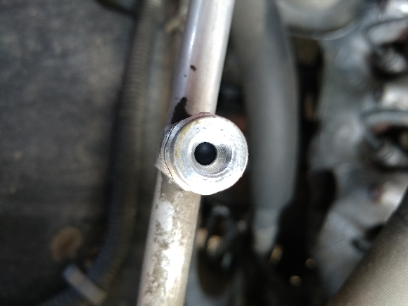

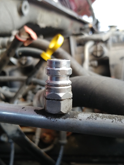

Post a pic of that high side port. I have never heard of such a thing. The pressure at that port is a lot when system is running. A threaded shrader valve will hold it but have never heard of a different way to seal it.

I've never seen anything like this before either. Looks like a rubber seal under the top part of the fitting.

Outside looks just like a normal fitting

I believe it’s a ball valve, if you look at the inside of the fitting on your gauge set, you should see a 1/8” or so post that will depress that black part in the fitting on your vehicle, when the gauge set fitting is screwed down

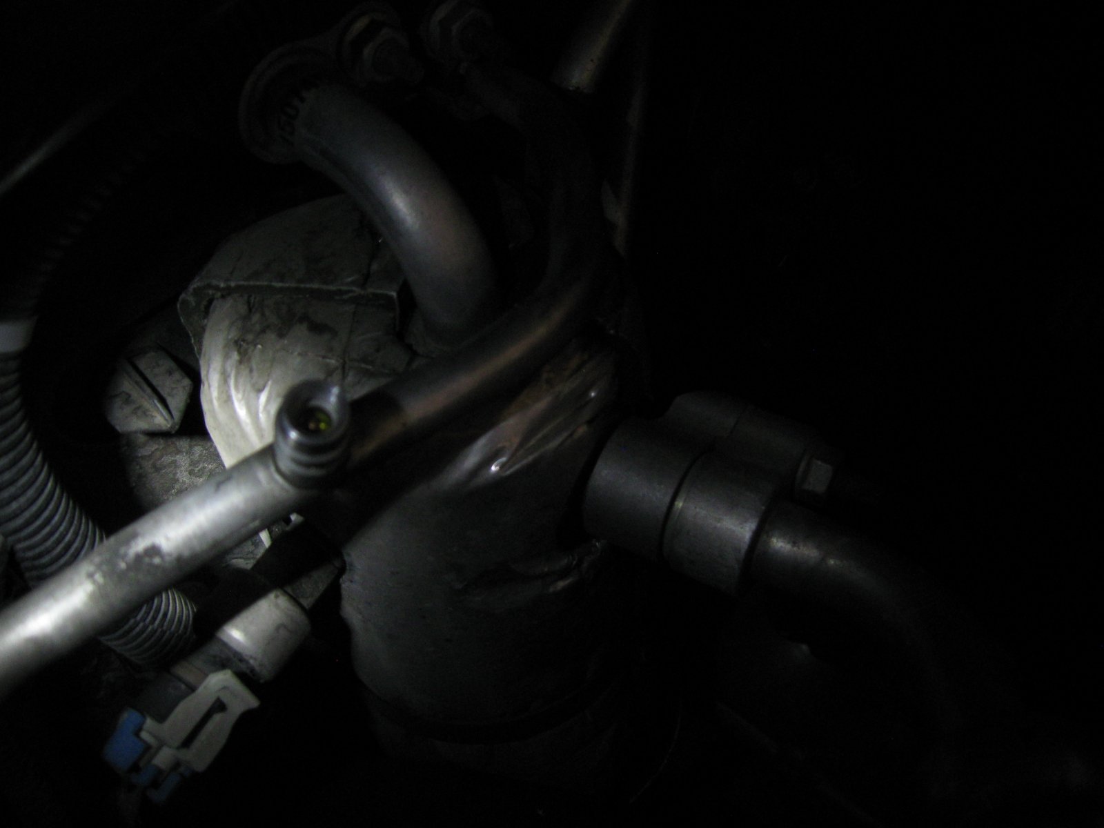

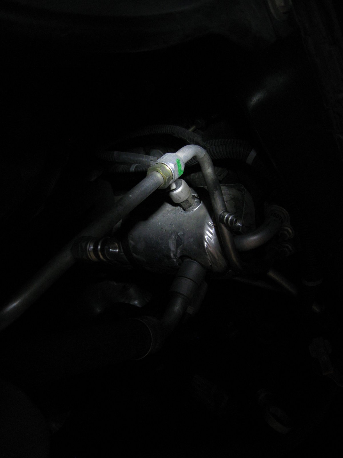

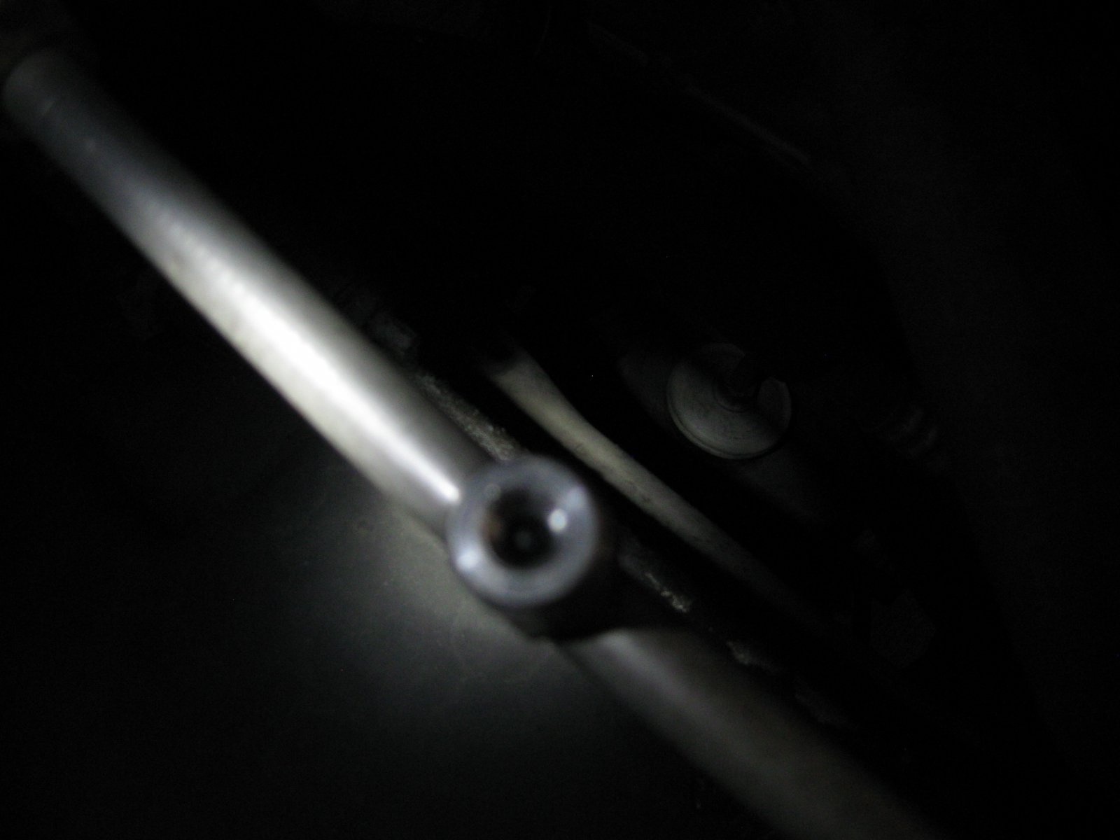

Ok, so I went to look at my 2002 Tahoe and I found two fittings on the high side line. The furthest forward had a fitting like this one you have and the one closest to the accumulator, in the same line, had a normal shrader valve fitting. Do you have 2 fittings in the same line? Here are very poor lighted pics but in one of them you can see the two fittings in the same line.

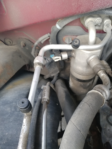

View attachment 245019 View attachment 245020 View attachment 245021
Yes there are two fittings on the same line but they are on opposite sides of what i understand to be the expansion valve making one the high side and the other the low. The high side is the one closest to the engine and the low closest to the firewall with the expansion valve in between.
That was my thought but the inside of my manifold set does not engage far enough to depress the ball valve. It will for a schrader though.

When I got my 02 the a/c worked flawlessly and still does after 5+ years and have never looked. But, since the orifice/expansion valve is in the same line then yes, the high and low are in the same line. The gauges will only connect to the right port as they are different sizes as well. As ks03 said, it does look to be a ball valve. Attach gauges to both of them and get a pressure reading and list the ambient temp at the same time.
It may take a different set of gauges or an adapter for the high side gauge line to attach.

Hopefully someone has more input on these valves. I watched a video and it said that the rubber valve can be damaged if screw the hose on too far. If I was doing the job I would insist on a new valve each time. Why would they change it from the old style?
No idea why it was changed but I am also worried about damaging it. I'll look into some kind of adapter. I was able to too off the system two years ago and just didn't bother to monitor the high side as it was working fine.

Ok...those 2 fittings are the high and low side to the system. That compression fitting is where the orifice tube is for the front AC system.
Btw..your connections look normal with that black rubber stopper in there. Thats normal and what GM uses from factory.
