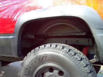

Paint: wire brush the rust off the frame, then clean it with dish soap and a stiff bristle brush then paint it semigloss black. same thing on the wheel wells...I actually sprayed the wells on mine but careful with overspray. I attached a picture

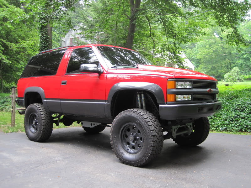

I say max 2" crank and a 1" block. Right now if you measure the fender height of your truck it sits at least 1" lower in the front. many people including myself have the back sitting the same height or a tad lower than the front to give the appearance of a level truck or no block out back and get the bulldog or cali look where the front sits a good bit taller than the back. The picture a few posts up of my truck the front is one inch taller than the rear but it look perfectly level.
