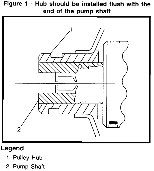

Since the power steering pump is original, it may not be your issue, but see if the pump shaft is flush with the pulley flange. It requires a close tolerance to keep the pulley alignment.

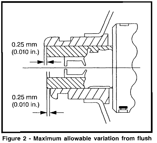

ok i went and verified the clearance on the P/S pump pulley. if your diagram is right the pulley has definitely walked itself out over the years. cant even see the pump shaft i had to feel for it. its a good half inch out. so i guess its that time. i know these are a real pain to do on these trucks also. r.i.p.

Just use a pulley puller/installer and push it back on. You’ll hear a difinitive “pop” sound when it’s set in place.

Agreed, I’d just reseat the pulley and not worry about a new pump. It really sounds like someone did work in there and never got it seated all the way on.

just wanted to thank everyone for the proper guidance here. it turns out the p/s pump pulley was causing it! I had a shop push it back on and the squeak went away instantly. i would do it myself i dont have the tool. im mechanically inclined and i would really never of thought the pulley could walk its way out that far. from what i know those pulleys usually pop into place once they are seated which is weird how it walked about a half inch out :hmm::hmm:.
