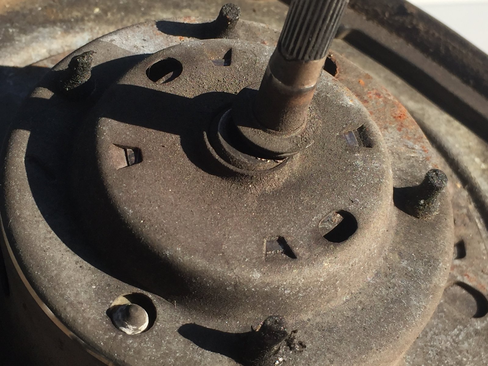

Thank you! I pulled the blower motor and it was completely shot. Somehow water got in and rusted the lower half of the interior motor mechanism. The rod was broken off from the motor and the plastic fan had broken off completely and even worn down some of the housing plastic. You can see in the last pic how badly the water affected the motor.

I'm still trying to figure out how water got that far in the first place.
Remove the blower and use a mirror to look up through the air intake. There’s a screw there that can let water leak in and it’s a straight shot to the blower. Have someone run a hose on the lower windshield and see if water comes in there.
Any new blower will eventually seize if the leak isn’t fixed.
Not the best picture, but the screw is here. It threads into the blower intake. Remove it, goober it up with silicone or RTV and reinstall.
