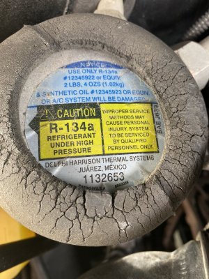

Check the sticker on top of your accumulator for proper amount of R134a charge
Only add as many ounces of PAG 150 oil, as is recovered in the process.
