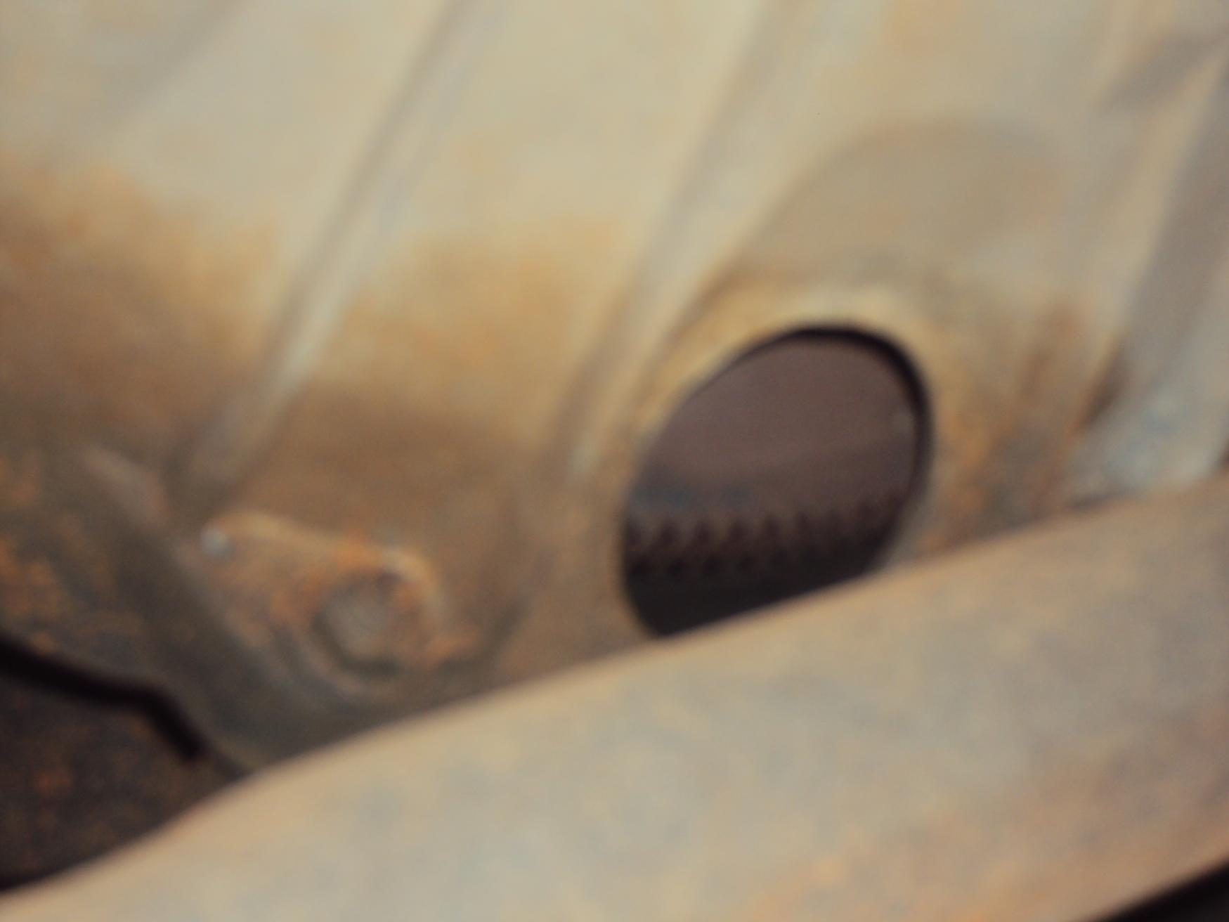

I'm about to change fuel filter...cleaned air filter...waiting for it to dry to oil. No lights have came on, and I have plugged in the reader and it's not sending any codes. Don't laugh...I just crawled under to locate exactly where the fuel filter was and noticed a large exposed hole in the bell housing....I'm taking it that's normal?
---------- Post added at 02:41 PM ---------- Previous post was at 02:26 PM ----------
I assume you have a k&n type oiled air filter.......do NOT over oil it or you will foul up the MAF sensor.
inspection hole.

yea looking through it you should be able to inspect the teeth on the flywheel and tC
