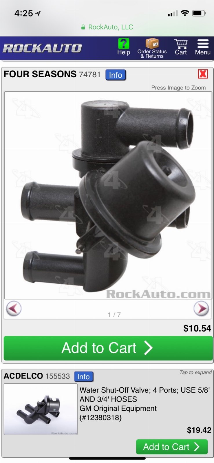

On the Tahoe/Suburban, there is a valve on the heater lines just before the firewall. A solenoid on the firewall closes this valve when the temperature dial is set to “max” to close off coolant flow to the heater core and, in theory, improve a/c performance.
There’s a plunger on the bottom of it that moves up and down to position the valve. That’s how you would know if it is working.
Ldillio
Ldillio
Jun 7, 2018
14
Cool I'll check that out
