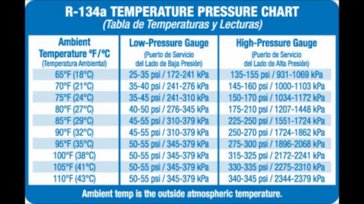

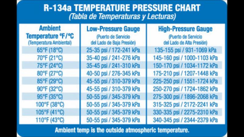

Your problem is staring you right in your eye and system told on itself with the frosted low side line. Your evaporator is freezing up because of low charge so no evaporation is taking place. Any A/C or Refrigeration system MUST have the evaporator temp above 32 deg or the system will not work because the humidity will freeze on the evaporator almost instantly. You are running 5-15psi low on the low side. You are just about at the low pressure cutoff switch pressure now. You are low on charge. The first place I would check is the valve cores at the service ports. Give them a snug. They like to leak slowly over time especially when they have refrigerant gauges attached to the ports and the gauge set hoses are moved around and those gauge adapters will back out the valve cores ever so slightly and its usually the low side. ALWAYS give valve cores just a slight snug after having gauge set hooked up.
