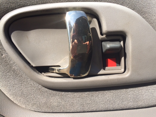

Hey y'all, is there a common problem with the door latch on these trucks? A particular thing or two to check first?
The inner latch on the driver's door, over a week or so, got gradually worse. I had to pull it a little bit further/harder each time to open the door. It won't open the door at all now, but I never heard or felt anything snap or give. I'm hoping it's just an adjustment issue.
What do y'all think?
Thanks,
joe

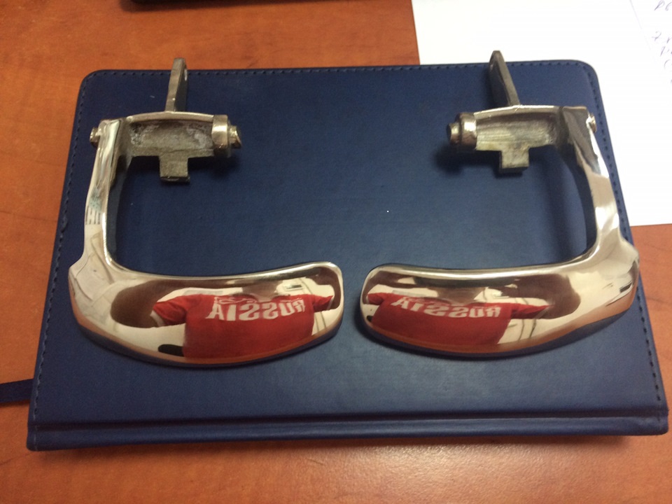

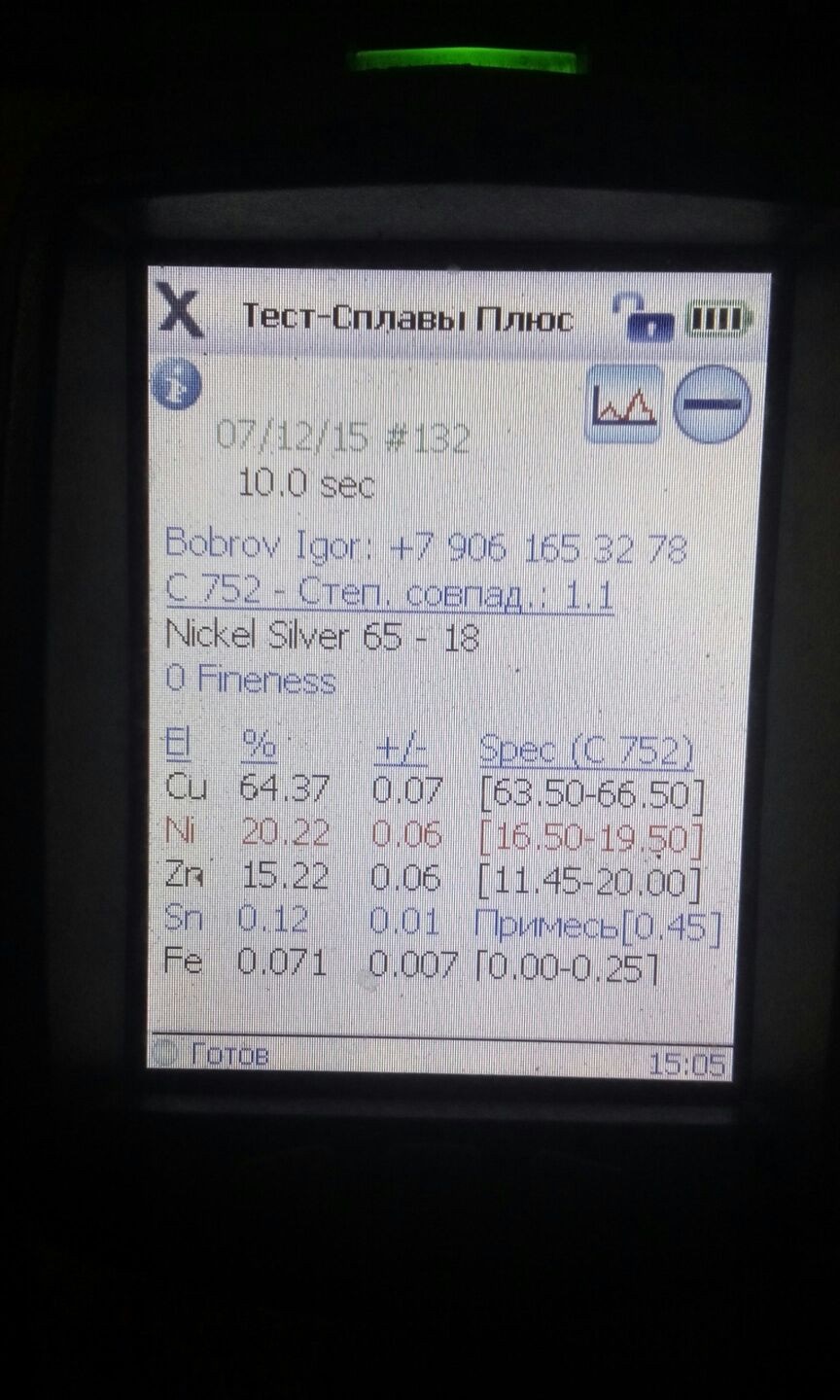

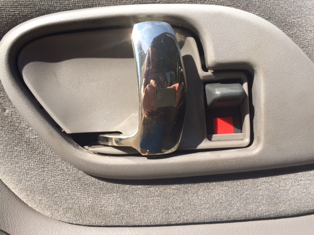

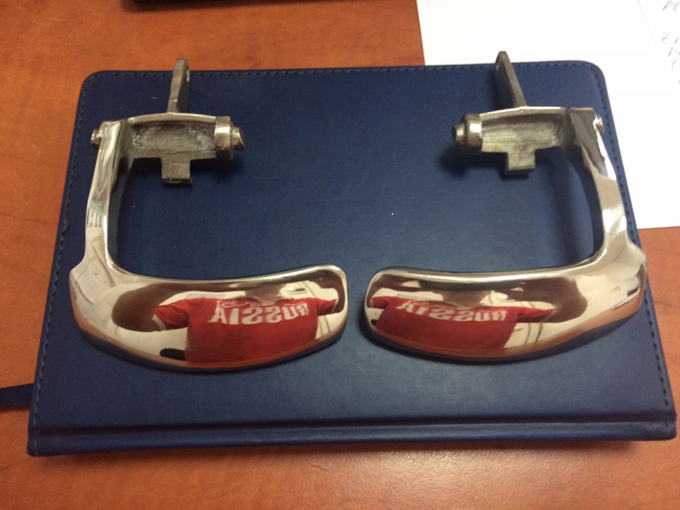

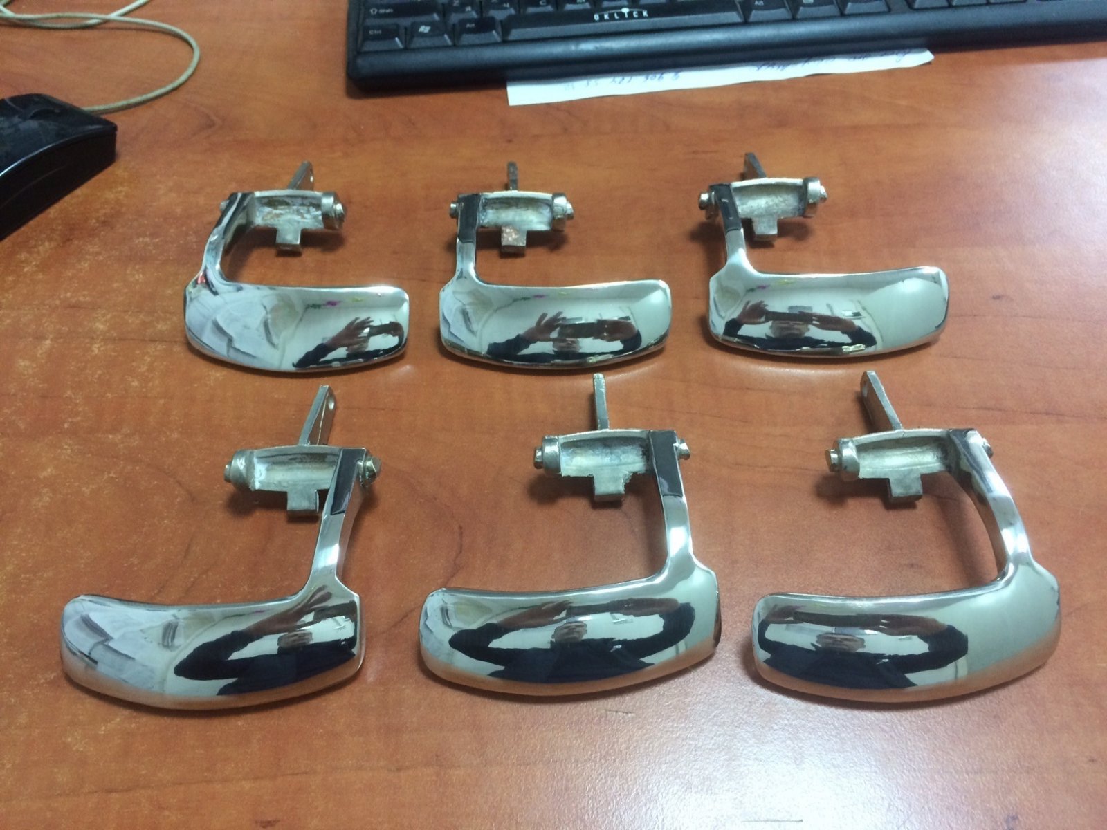

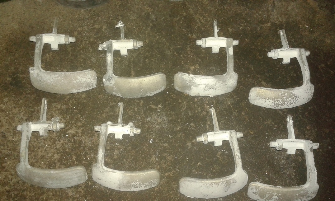

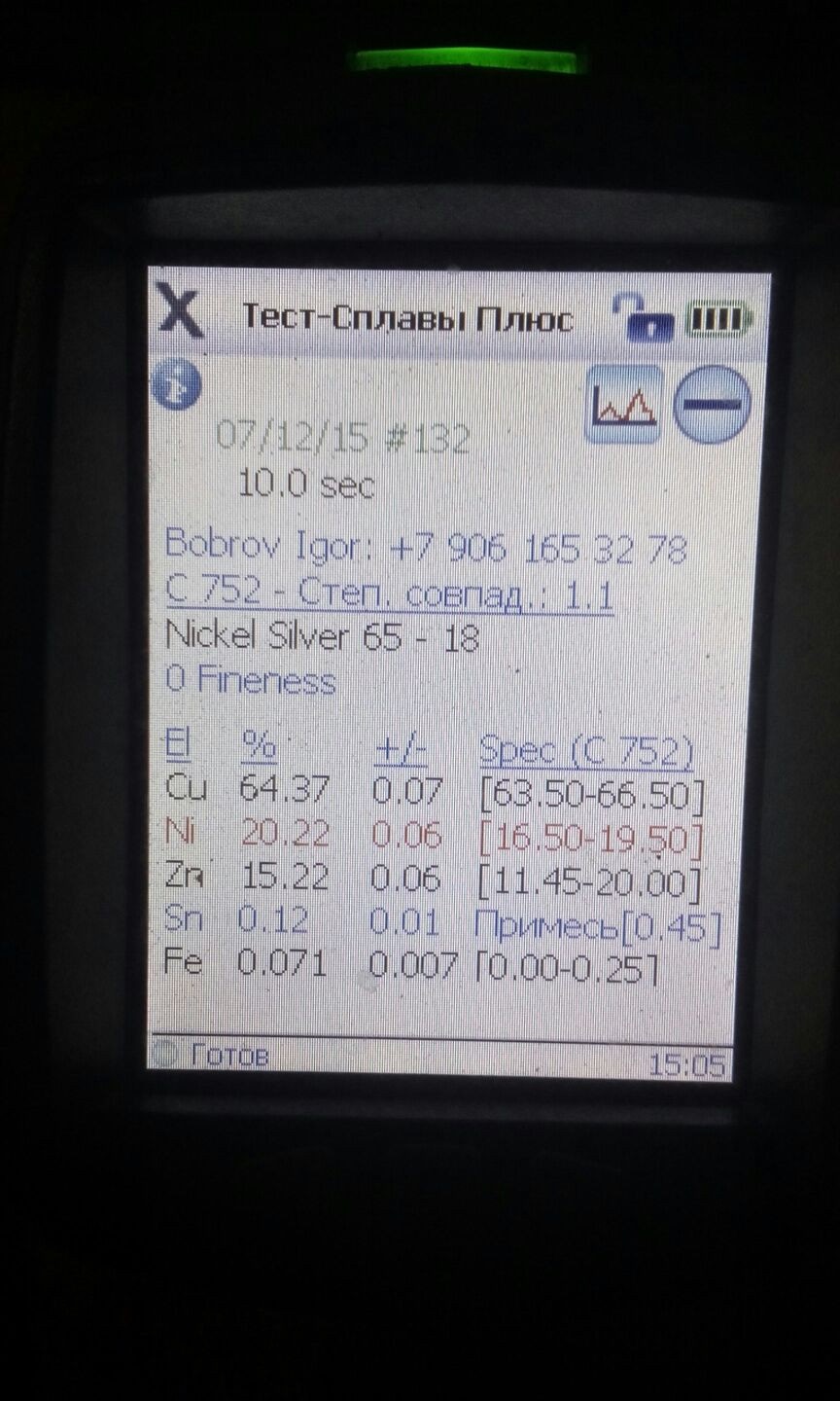

Hello colleagues!
This is a constant disease of the square Tahoe Suburban 95-99.
Adjusting the rods and the good condition of the fingers of the loops HELP.
But, forever solves the problem only the material of the pens.
And this is casting.
I made pens from nickel silver ...... and forgot about this problem)
P.S. I don’t know how well I translated my text Google Translator from Russian into English.
https://www.tahoeyukonforum.com/threads/eternal-internal-handles-of-obs-95-99.116494/
