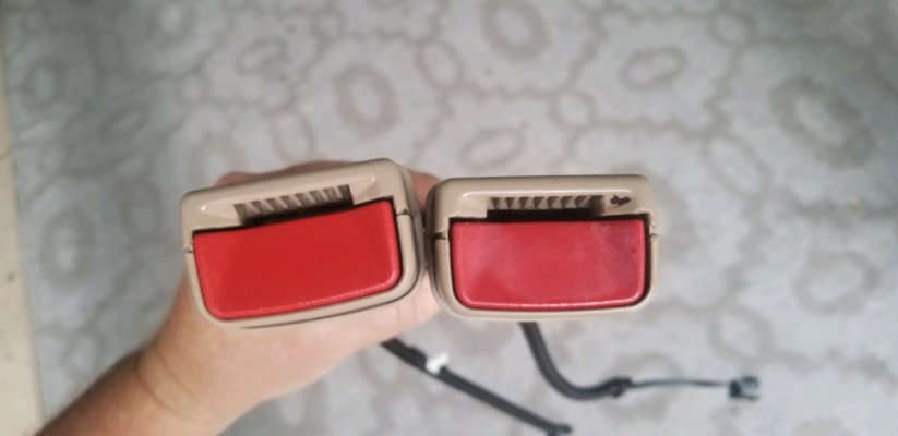

You will soon notice your passenger side latch button to be significantly faded compared to your new driver side.

I'm sure our metro-PHX 110+ summer temperatures don't help the situation either.
Should indeed be interesting to see how faded the old one is compared to the new ;)

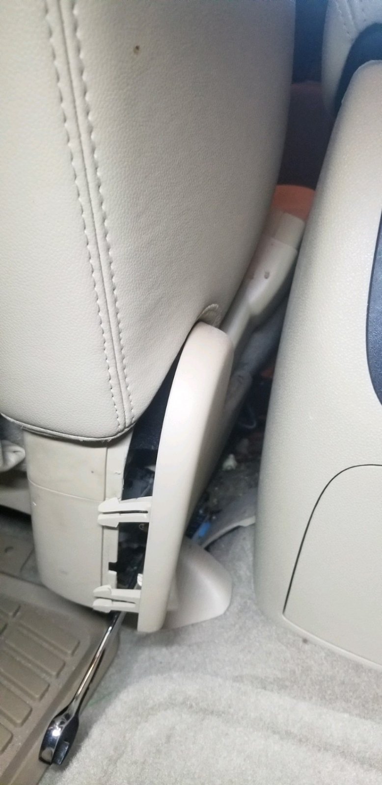

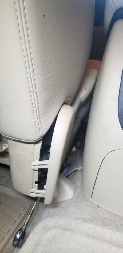

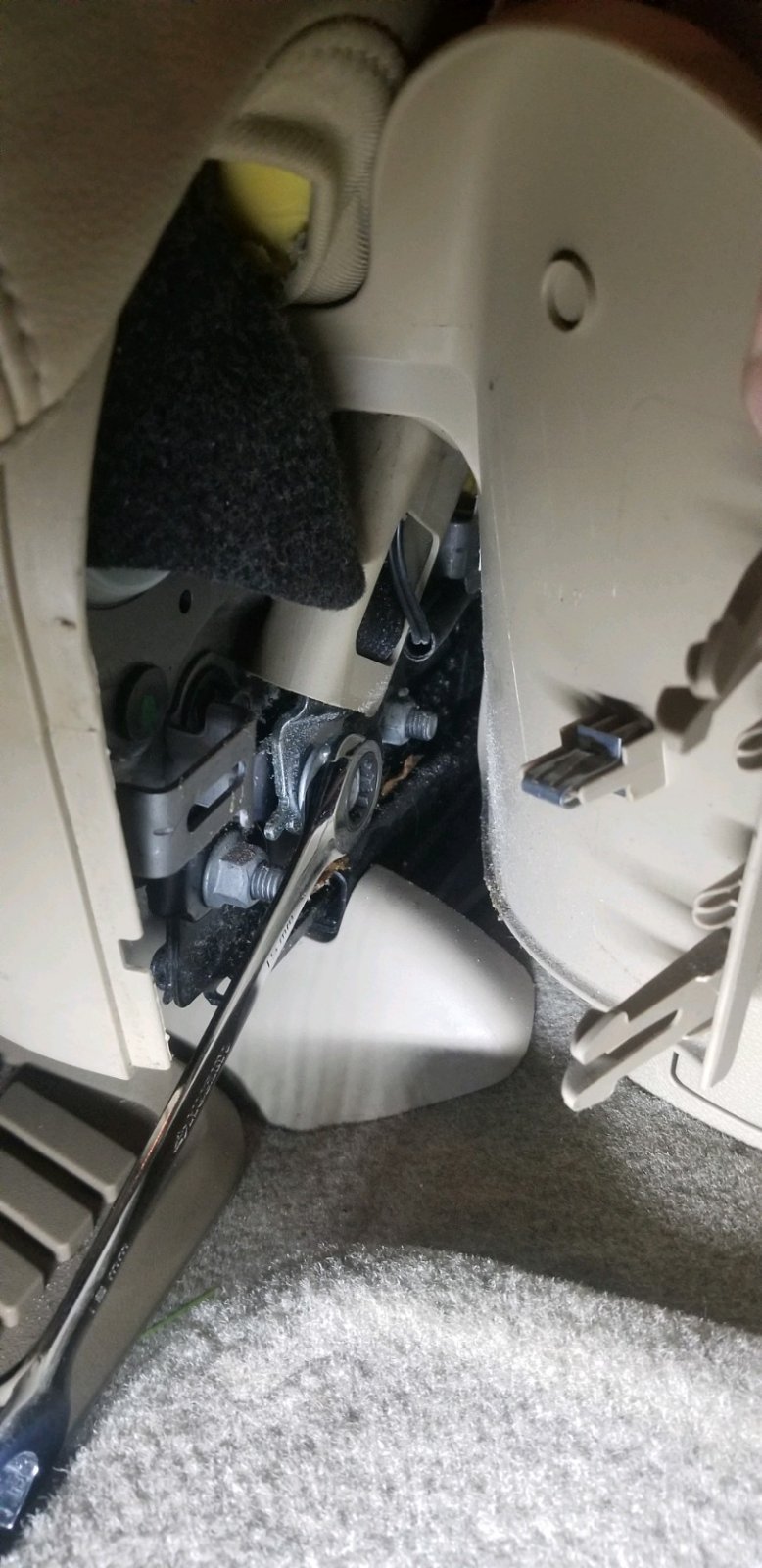

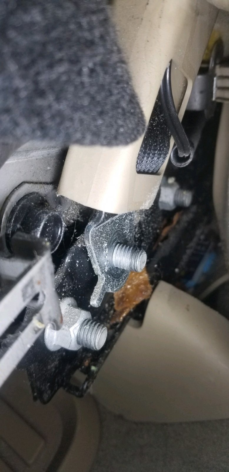

Got it installed rather easily other than getting at the seat belt warning harness plug.
One simple 15mm bolt that easily came off/on with a ratcheting box end wrench.

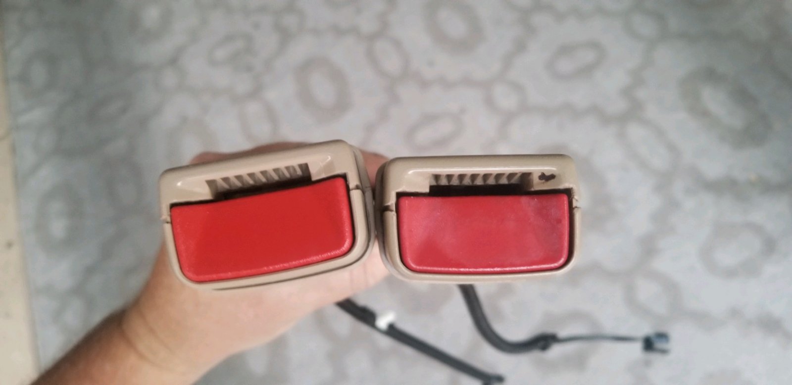

Used a hacksaw blade to manually cut the stem off the old white plastic wire holder so it fell off, allowing the new one to easily pop into place The orange release button on the new receptacle is bit brighter than the old one, but not a vivid difference. (LH is the new one)
Anyhow, glad it's done and my bride again has use of her seatbelt! :)
