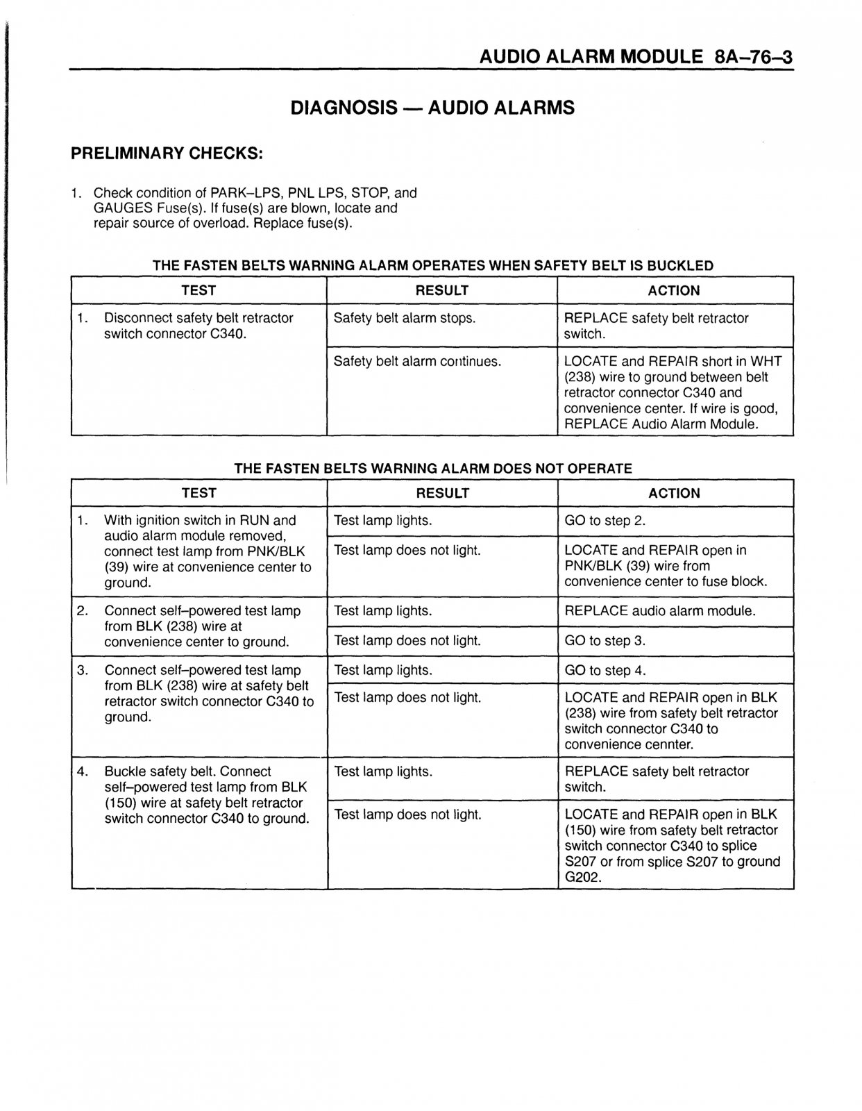

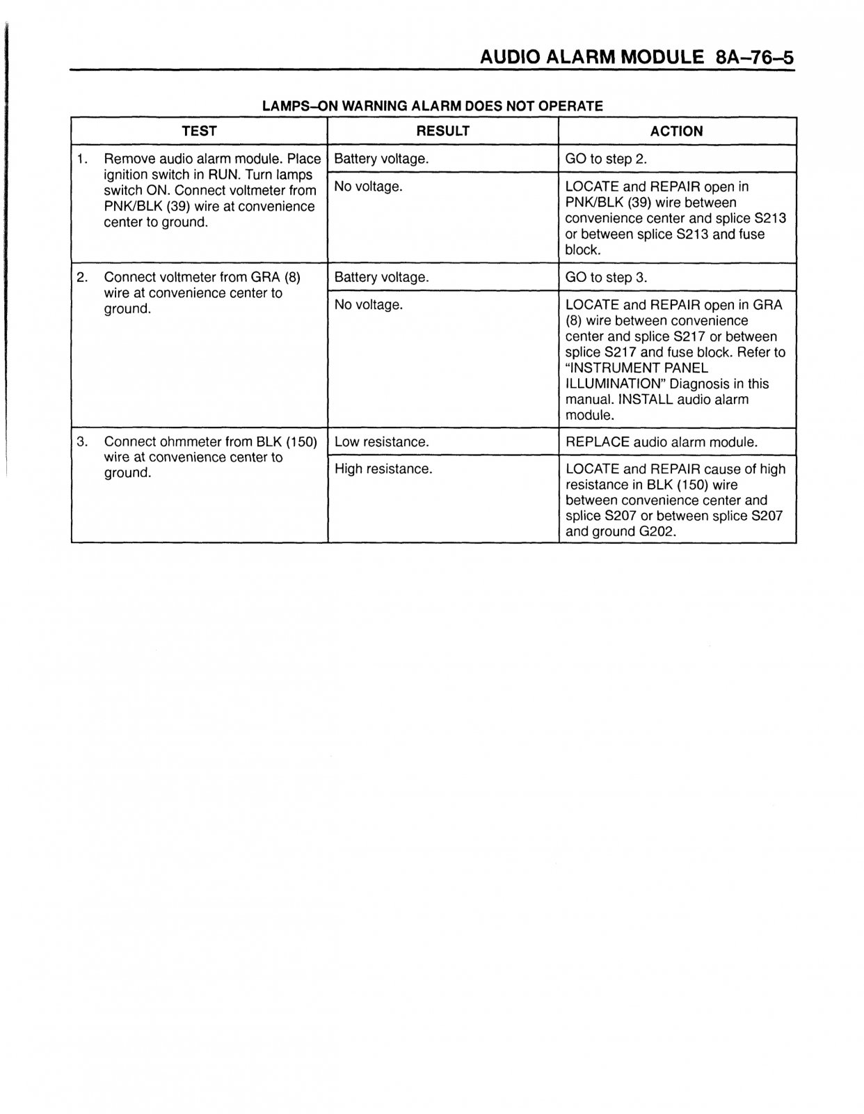

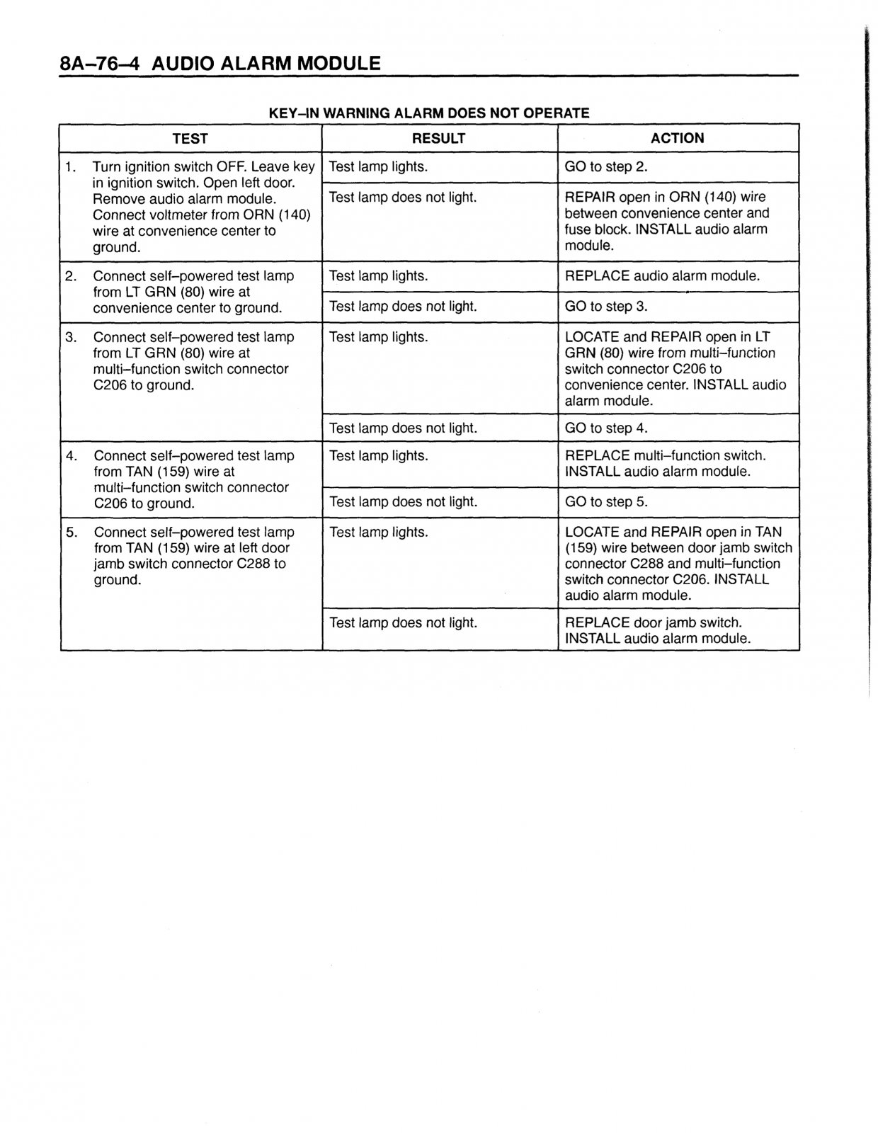

Here are the pages from the 94 manual, maybe they’ll help. If the seatbelt alarm also doesn’t work, I’d be looking for a power issue or maybe loose ground (by the data link connector under the dash).

Very common for the door jamb switch to be bad, totally poor design. Also check your brake lamps, same fuse if I remember correctly.
