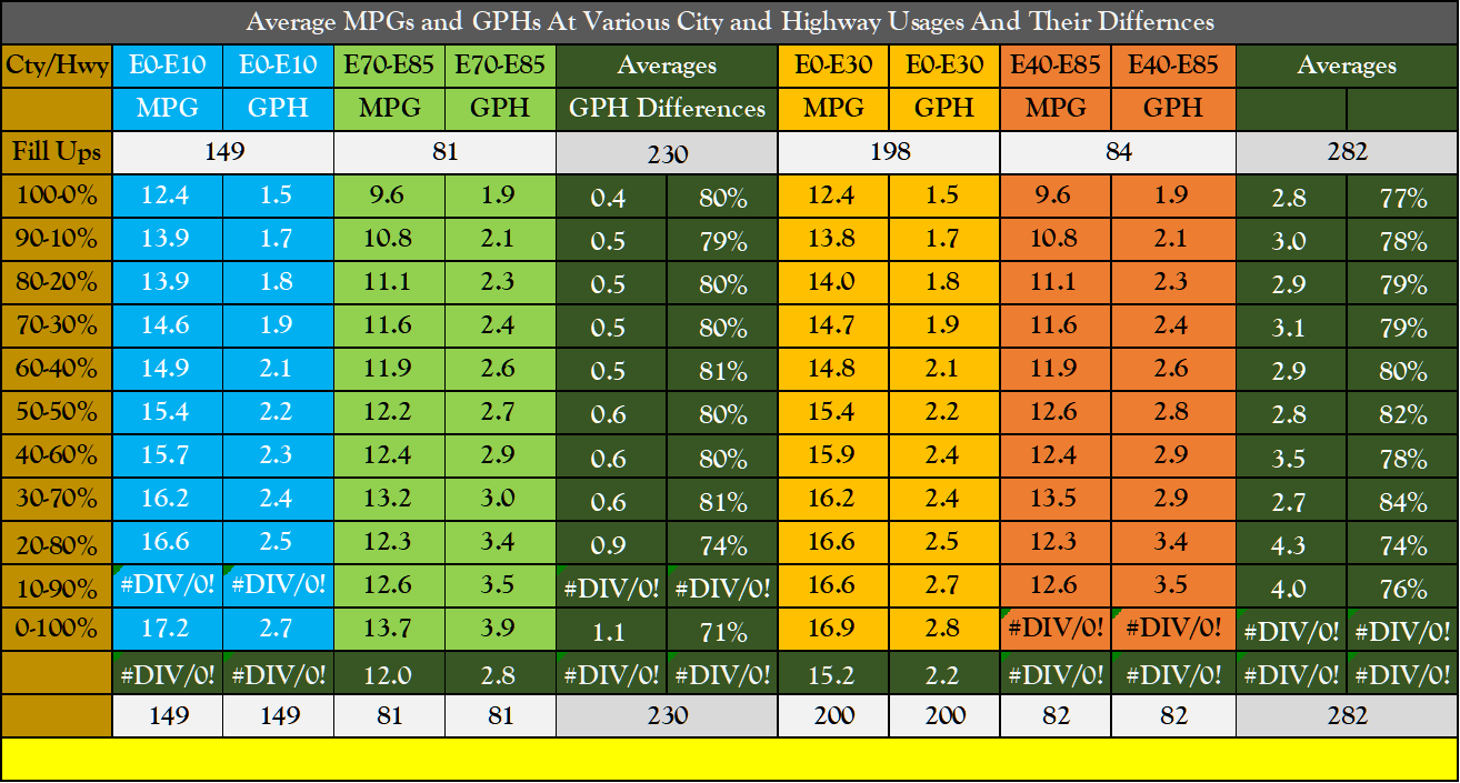

Here are the stats for my Yukon XL with the 5.3 motor:
You can see that for all city driving and 70% highway driving for a tank of fuel, the mpg difference is about 20%. Eventually, the faster you go the greater the spread between the two fuels cost wise.

The motors love E85 and take 5 tanks or so to get fully acclimated to it. The engine makes more power, idles smoother, cooler and even the transmission runs better. It's literally like cheap race gas. Oh, it's also a great injector cleaner.
When we are not planning to travel, we run E85. If we need the range, we run 93. I never intentionally run low octane fuel.
