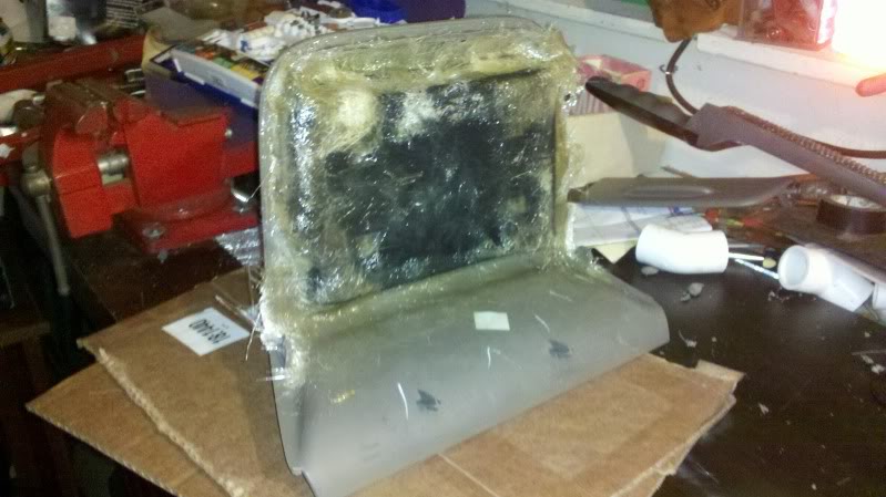

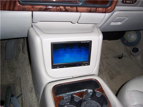

the hardest part about it was how picky i was getting every step of the way to try to do it the way i wanted..... and even after doing that id still like to try it again. not 100% happy with it but itll do for now.

Luke, it looks great in the pic. Paint it the same color as the rest of interior or wrap it. Good job.

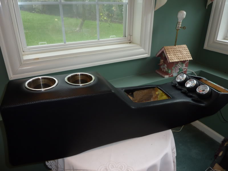

that was for my 03 never got it done. truck got broken into and i sold the boxs.
the rest i did or helped on

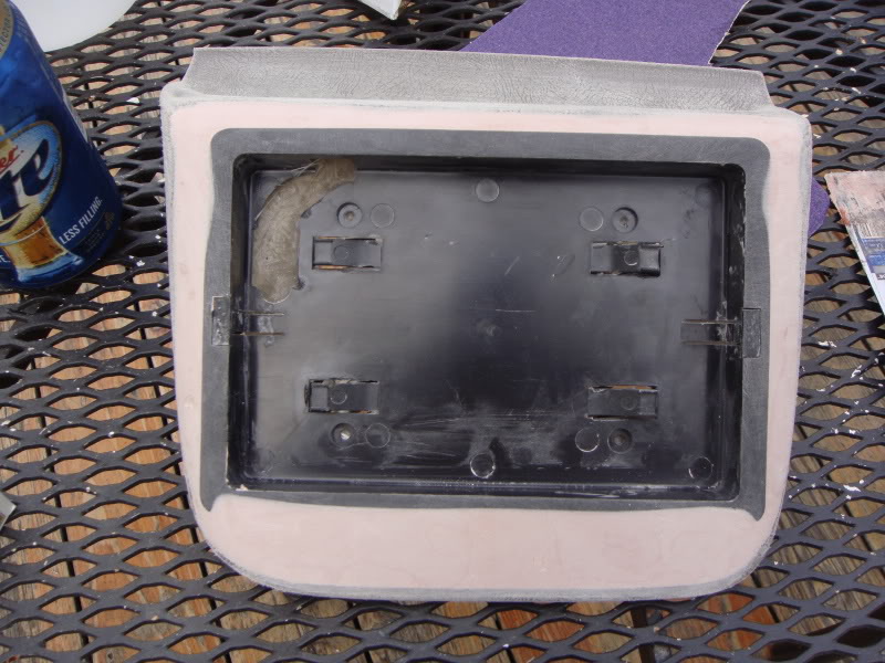

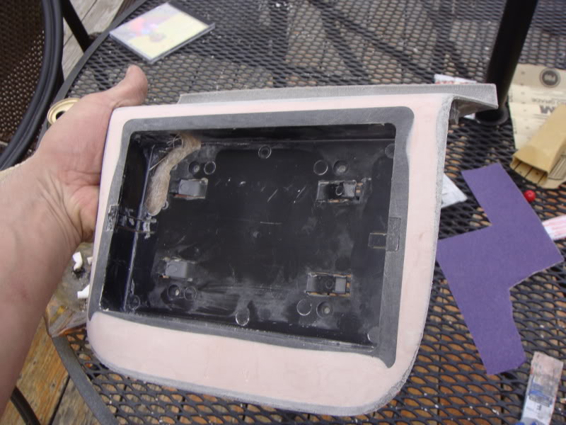

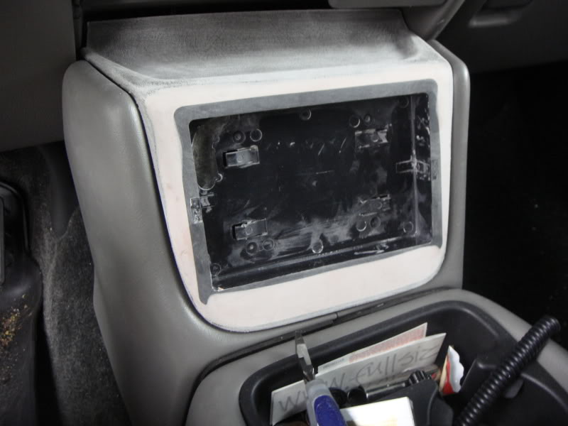

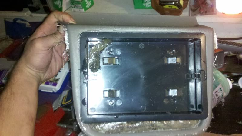

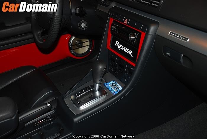

Forgot that i moved all the pictures to a different album in my photobucket. I dont have step by step pictures but these should help a little.
My monitor came with a plastic back plate so it made it alot easier to form it. I cut the hole big enough for the back plate to fit.
I glued it in place and just laid some fiberglass on the back of it then put the resin on.
After that hardened i filled in the front with bondo and sanded it all down.
Hopefully this will help you a little bit.
