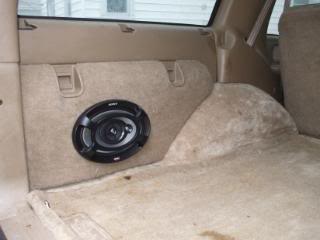

i put mine in the side, had to take out the jack and metal to hold it.

Looks good MUDDER TRUCKER... but if I was gonna do that and pull the jack, I would have made a small custom box for each side to hold 2 10's (1 each side) .... but I have a 2dr and good luck doing that with the spare being there too! Still looks good though and ya the 6x9's are definitely a needed upgrade! or 6.5's work too!
