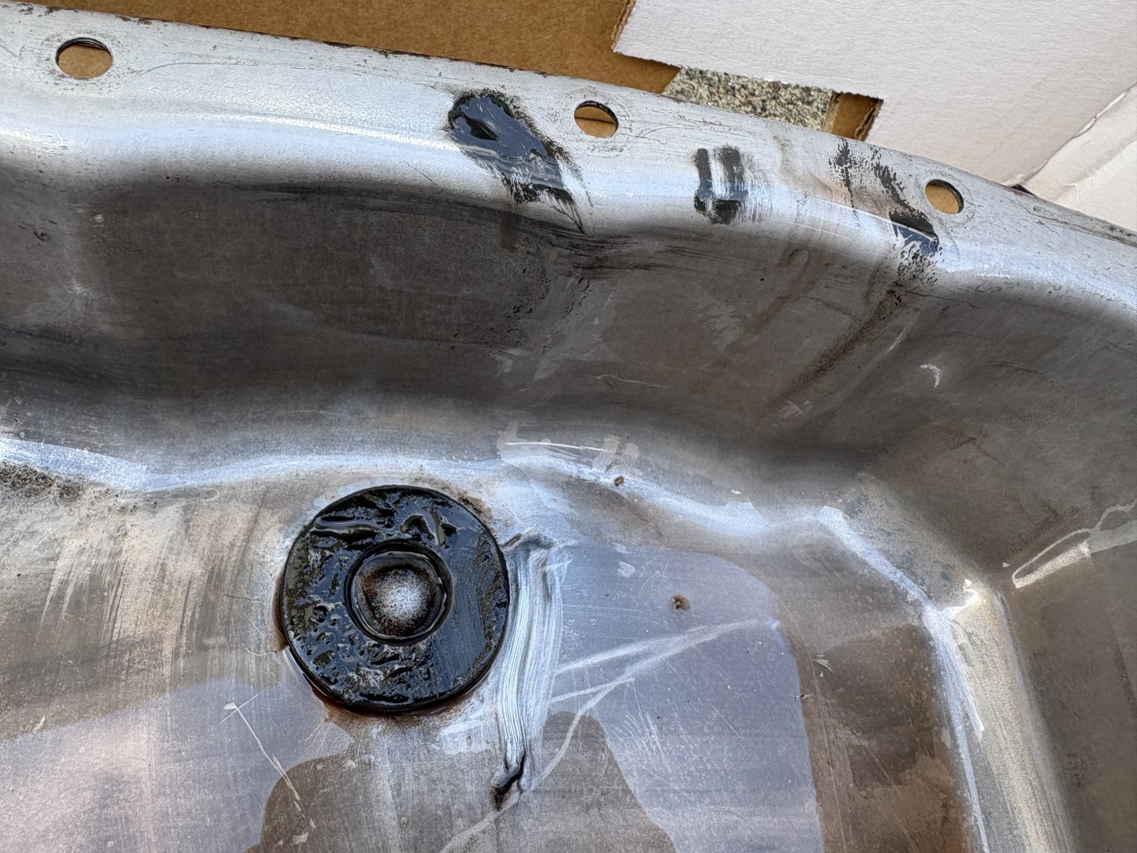

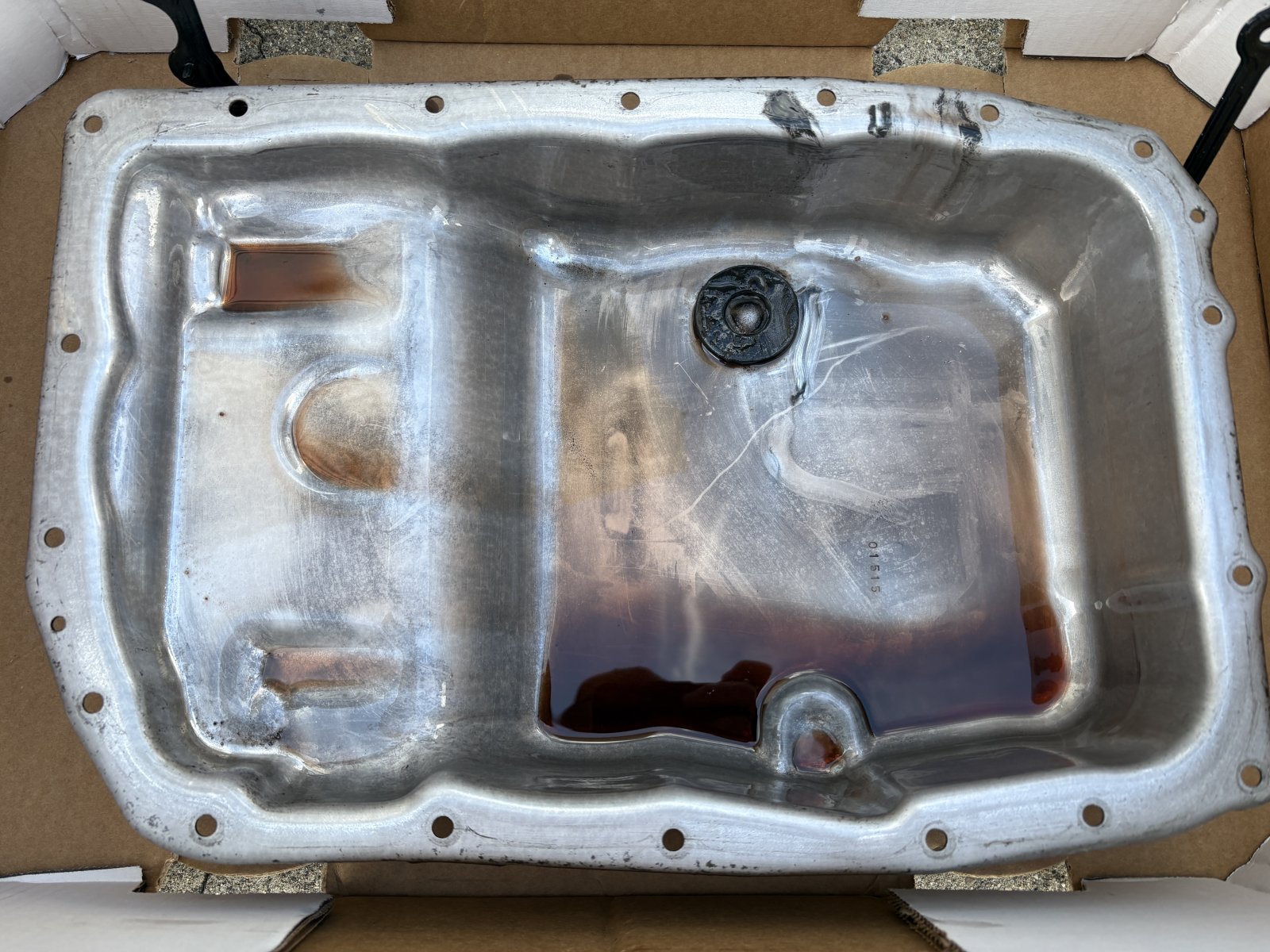

Just did the transmission filter and the little circle filter gasket thing and wanted a second set of eyes on the condition of the bottom of the transmission pan.
Suburban has 188,000 miles on it. No idea when or if the transmission was previously serviced.
I wiped the magnet off and smeared my finger on the rim there and then drug my finger across the bottom of the pan to try to give an idea of how much build up there was.

The fluid is on the used side, but overall the pan looks pretty nornal to me. Clean off the magnet and wash the pan out with brake clean. Wipe off the gasket areas and reuse the OEM gasket. Good to go

That pan looks great for that mileage. I'd guess it has been changed before. I leave that filter seal in and reuse it, no real wearing and it's bathed in oil.

Pan looks fine for the miles..no bent flanges..
magnet not covered with metal shavings...just abit..close to "normal"..
fluid needed changing..
I recently 5~7K miles ago did filter & fluid.
I could not get the pan off. so sucked out fluid with vacuum pump. wiped pan out.
stared at what was on the paper towel..again same as yours...
