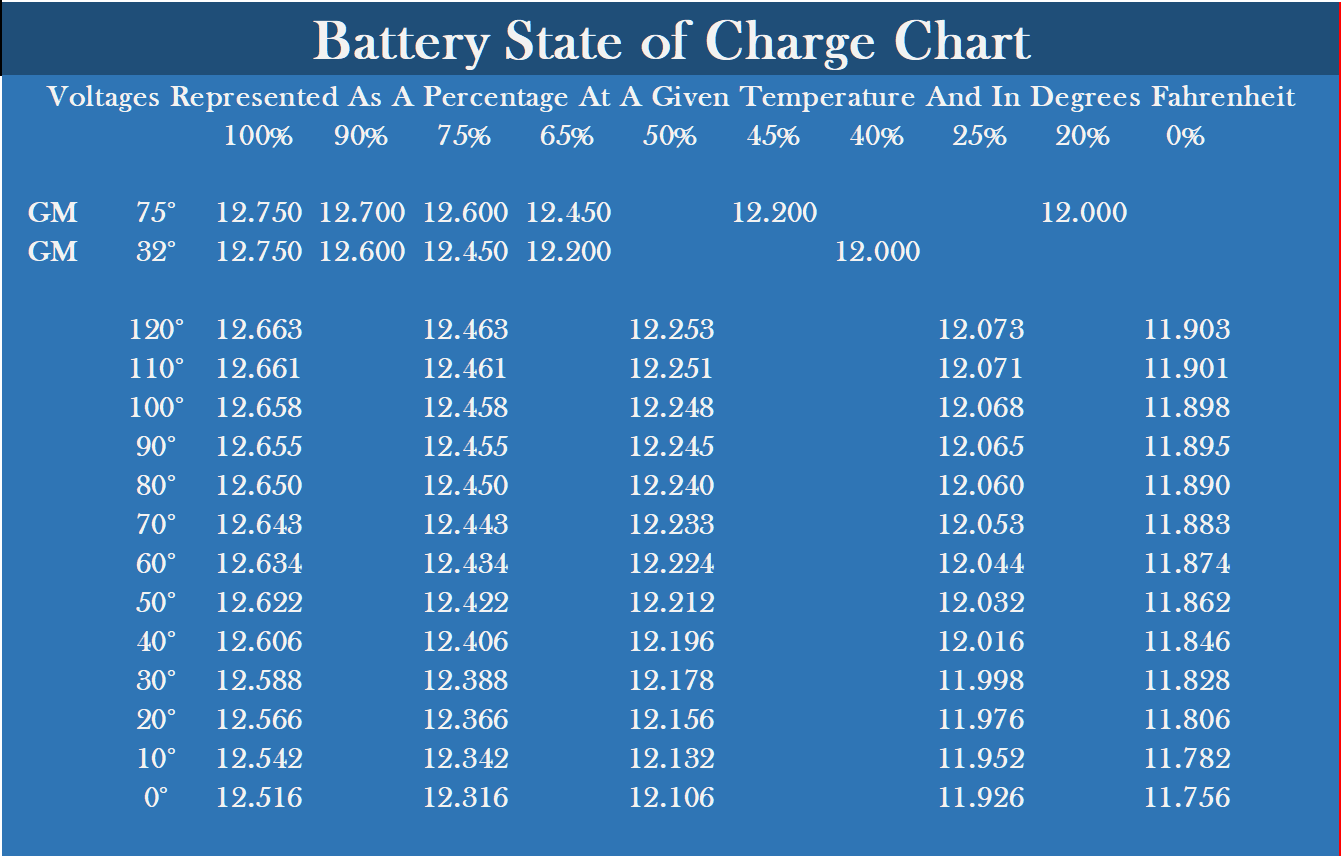

@07blackeddenali How old is your battery and what was its voltage this morning (engine off) and the temperature outside?

Battery is only 2/3 months old and I have no clue lol I’m gonna mess with it tomorrow morning on my day off

So I checked all the ground I could find under the chassis and this are good, found a couple in the dash that I could access with tearing the dash apart and those are good. As I just went out to start it to go home for lunch it now won’t start, all lights are on the dash, battery has 12.2v but it won’t crank. I’m leaning towards checking the fuse box cause also as stated above it’s a known issue a coworker had to change his on his 2010 Silverado 1500
