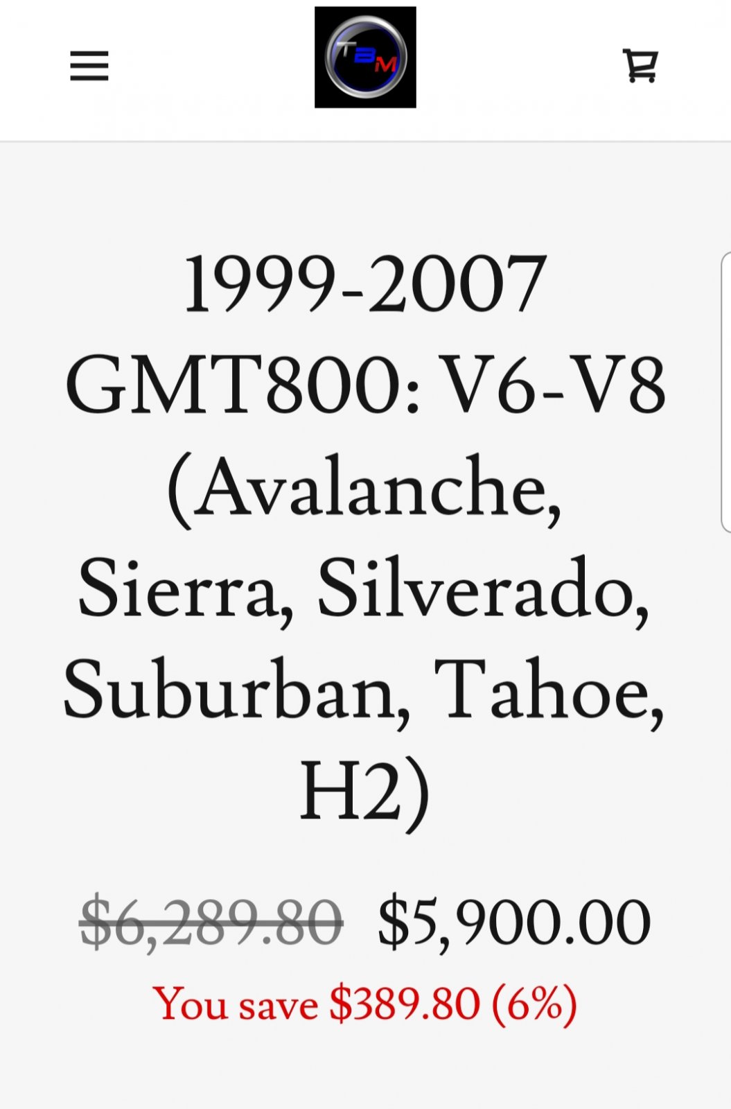

Thanks everyone for the posts. So it is a possibility with TBM, but it has a price tag attached to it. As much as I'd like to convert to the 6 sp, I think Doubeleive said it best.

Yeah the price is a huge shocker. I am hoping as more people figure out the electronics side of the transmission, the controllers will start to come down in price.
I agree with him on everything except the 60e part. Before I spent any money on a 60e, I would swap in an 80e instead. The upfront labor IMO pays off in the end of never having to worry about even a built transmission failing.

This company offers a GMT800 swap kit as well. They are gaining popularity in the trailblazer ss community for 6L80 swaps. They seem to offer good results in that community but they are expensive.
Their old website here has tons of useful information about the transmission as a whole:
