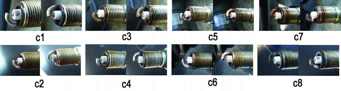

Got a chance to pull plugs this morning. oil of course...don't look good. anyone read plugs? I seen on a site before that a plug can be read like a doctor.
Was going to do some kind of oil flush and maybe try to do the valve seals. never done before. and cover gasket tonight-tomorrow.

Running low on oil can have a severe effect on the rings, by the looks of some of your spark plugs, you could have some bad oil rings.
Have you done a compression test?

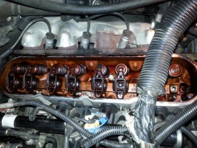

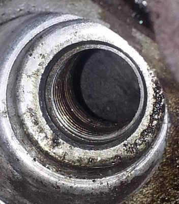

Been a couple weeks and finally got a chance to look at my truck. I decided to change the valve seals. Opened up the valve cover and it looked varnished up inside. Not sure what 210k miles buildup should look like.
Wasn't sure how much psi I should use to hold the valves up. I set the regulator to 40psi. I ran into a problem when I hooked up the air to the cylinder my little 3 gal compressor gave me about 7-8 min before it lost too much pressure to do the job. Good thing I tested to see how long the cylinder could hold pressure before I pulled the spring just to see the valve to fall. Decided to stop till morning before I even start. I heard the air escaping from the valve seals but more from the oil filler tube. Doesn't sound good. I had good numbers on previous compression test. I guess I could have good compression but bad rings. Not sure what to do at this point.
Do the seals quick at a lower pressure to give memore time... 30 lbs maybe and run an oil additive to try to clean rings not big on additives but I think that’s all I can do before a new motor as this one fails. Some pics of what I’m seeing so far. Any help would be greatly appreciated.
