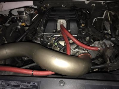

Swap went good I used the pcm from my 5.3 sent I off and had it tuned for the 6.0 I also put a btr stage 4 cam in it I just ordered a built 65e transmission from Monster transmission

What converter are you going to run?
