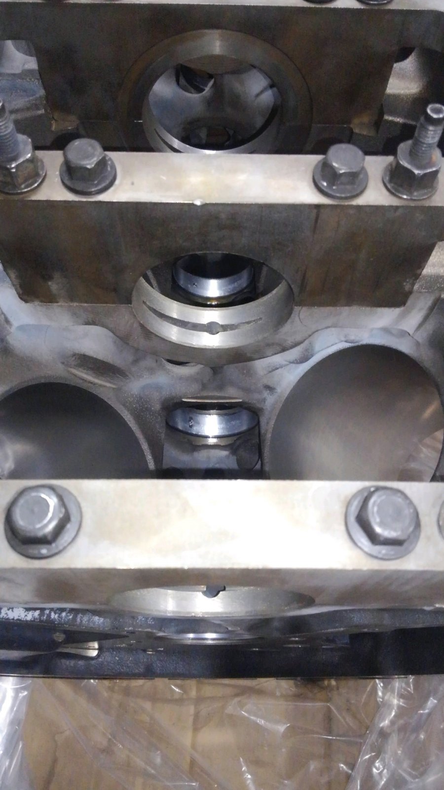

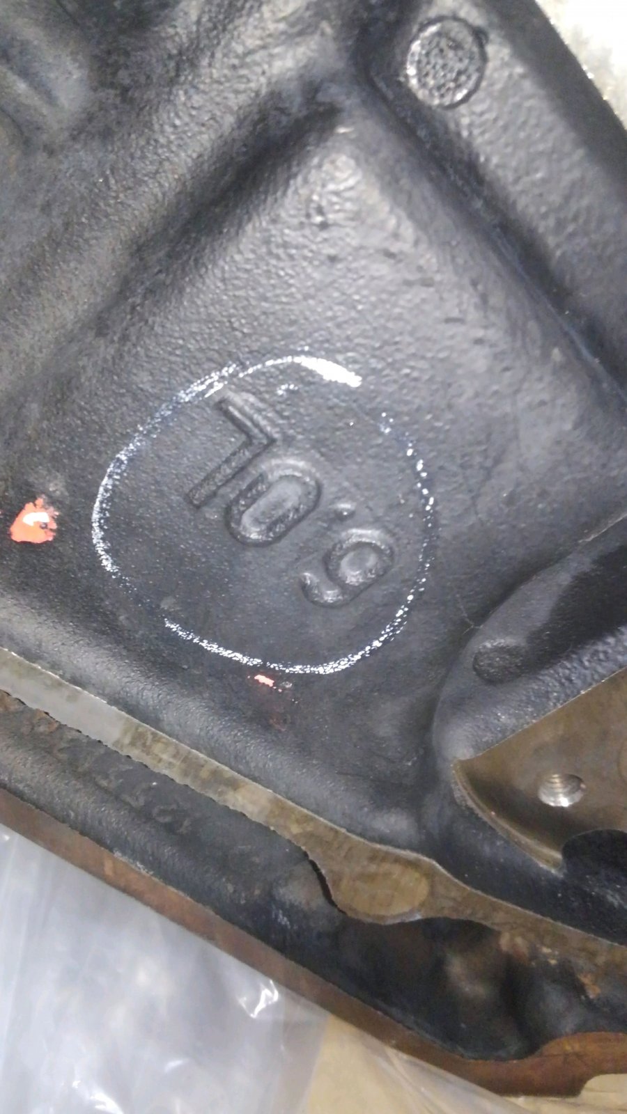

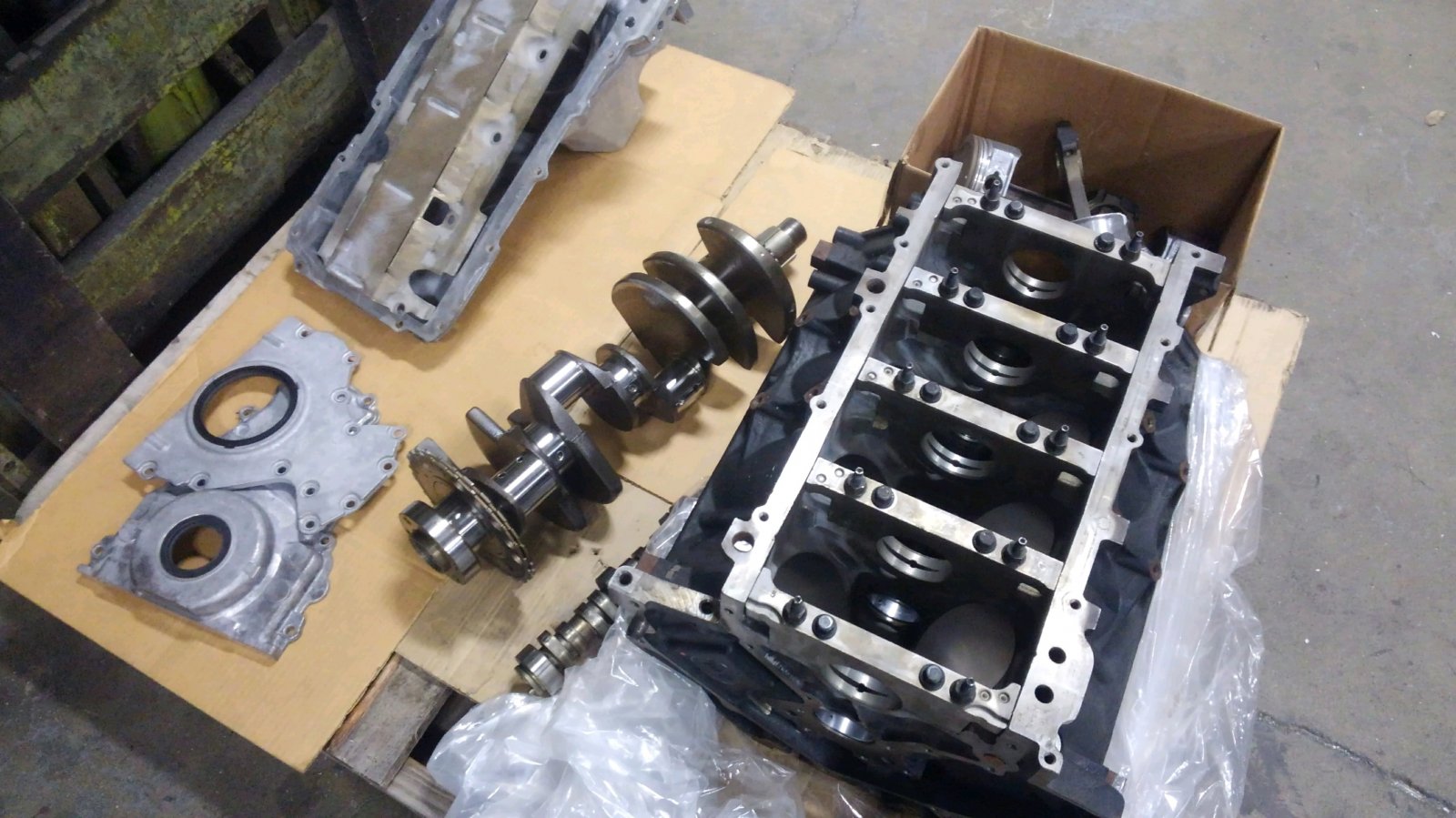

Finally got around to posting an update here. Parts back from the machine shop and done. Block went to 020 and crank polished up.
Now to order pistons, parts and decide if it's going back together as an lq4 with dished pistons or an lq9 with flat tops. i have a pair of 317 heads and also a pair of 243 heads but will have to determine which heads to use once i decide on pistons so CR stays reasonable for a daily driver. Going to look at a TBSS for a song on Craigslist this weekend too. Slowly it's coming together. KIMG1650.JPG KIMG1652.JPG

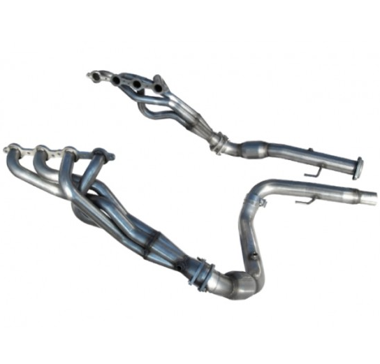

The Eskys and Denali’s don’t have an actual y pipe but instead they run dual pipes all the way to the muffler which is a dual in single out, and from the muffler back where it goes over the axle it’s a single pipe. It’s a much more open flowing system imo. If you look at ARH or Kooks you’ll notice they don’t sell a Y-pipe for this year 6.0.
Thanks for the picture. You are right, I guess it's not a Y pipe but instead 2 individual pipes that go into the muffler.
Anyone already BTDT and found that these will bolt into a 5.3/4.8 Tahoe? Are the mounts the same or is there re-engineering involved in swapping to the factory 6.0 dual pipes?
My thinking is if it's what the factory did, it was done for a reason as they could've saved a few pennies per vehicle if they had one standard Y pipe setup for all SUV's.
I’ve never seen the Escalade LQ9 setup, but on my 2006 LQ4, it has a the dual pipes coming down into the muffler, but my stock was a dual in/dual out muffler and then after the muffler the two pipes flow back into one before the axle to the single out exhaust. Not a dual in/single out like you said. Maybe a specific change to the 2006 model year? Maybe the earlier year 6.0 SUVs had the setup you’re talking about?

Thanks for the picture. You are right, I guess it's not a Y pipe but instead 2 individual pipes that go into the muffler. Anyone already BTDT and found that these will bolt into a 5.3/4.8 Tahoe? Are the mounts the same or is there re-engineering involved in swapping to the factory 6.0 dual pipes?
I believe the only mount before the muffler is the one that bolts to the side of the trans so if you don’t have one of those you could grab one off a Denali/Esky. I believe they did the exhaust different for performance with the 6.0.
Are those the ones that are showing in the picture you posted that look like an L shape round rod after the cats?
52,949
Yes. I looked up the parts on a dealer parts site and the Tahoes use the same mount although I don’t see those same rods on those y-pipes so you might have to get one from a wrecking yard Denali/ Esky if you don’t have that bolted to the side of your transmission.
