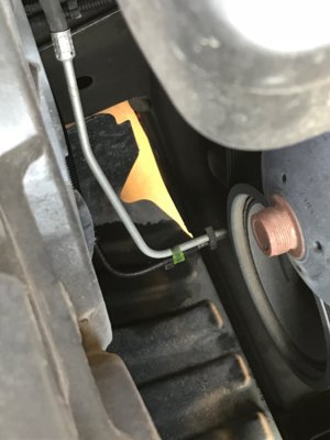

Yesterday, I did notice this when I got home from work and popped the hood. I am not an expert by any means, is this a leaking oil cooler? I have not noticed this before. It looks like I have lost a fair amount of oil through this hose.

Yep, it's a wear item and should be replaced. You can do the whole assembly or just cut out the bad fitting and put a new hose over it with double clamps on each side. The latter is much easier to do.

Thanks for the suggestion. I think I will go the easy route and use the hose clamp.
have you not been regularly checking the fill level of the various systems?
is this leak you pointed-out puddling on the ground?
make sure all of your fluids are topped-off and remain so before you go chasing your tail LOL
