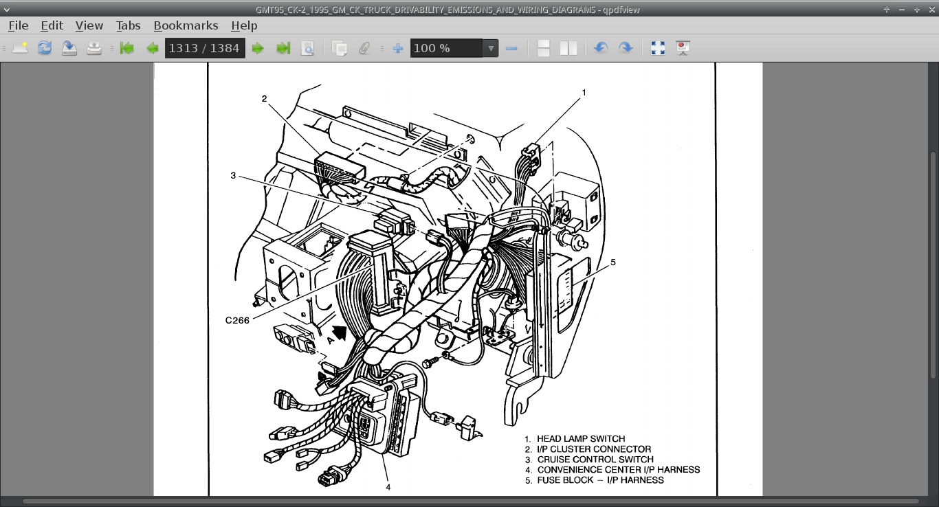

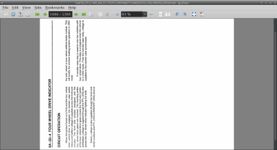

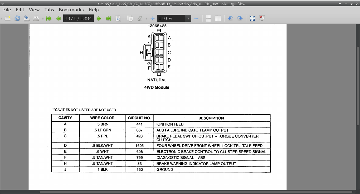

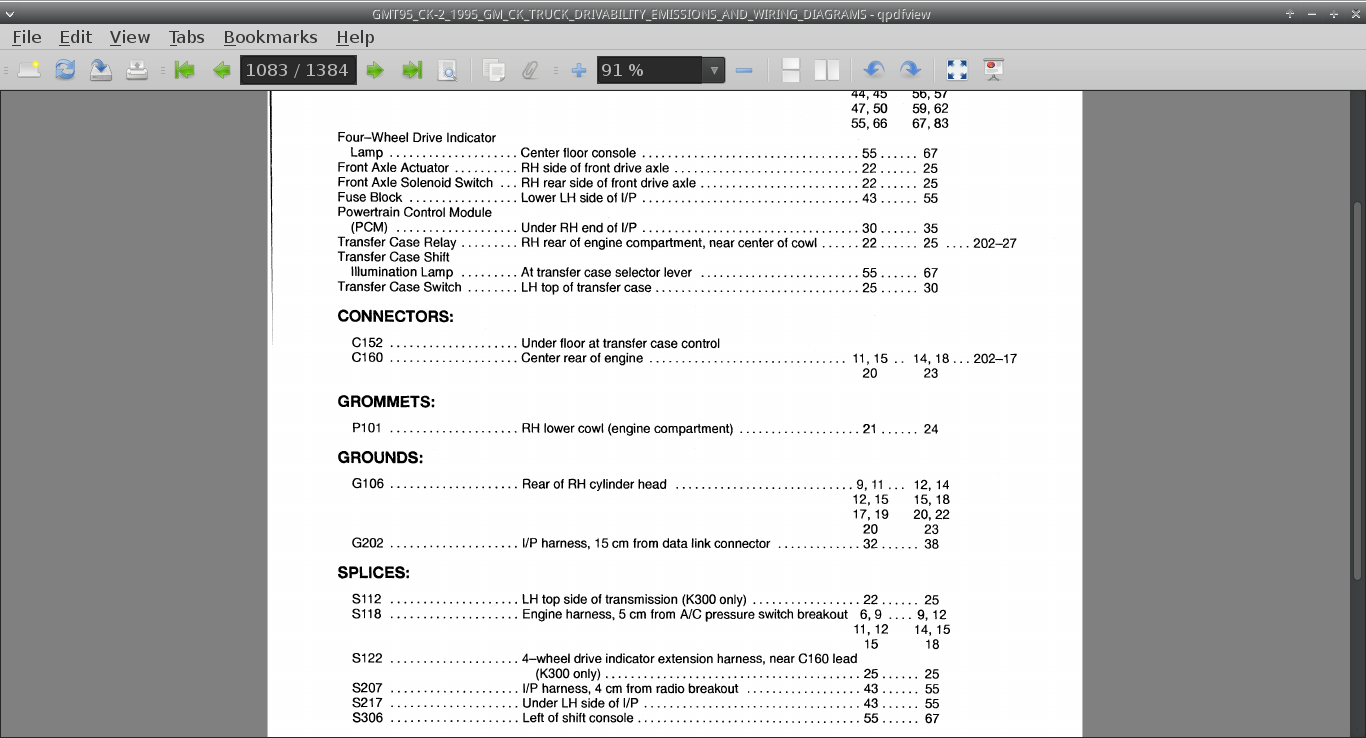

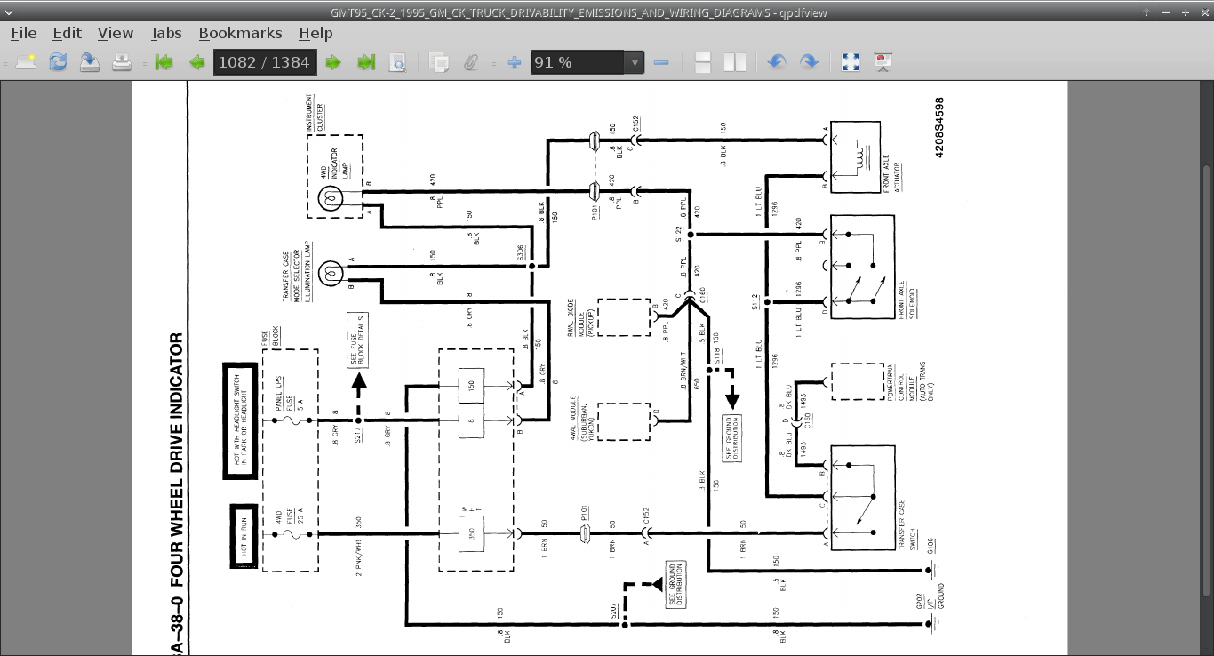

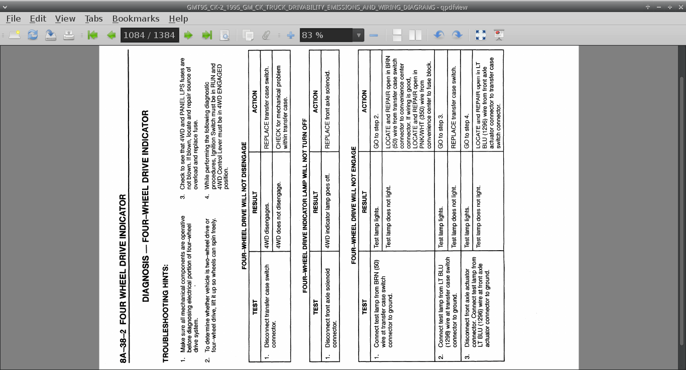

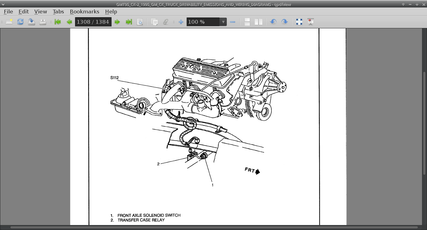

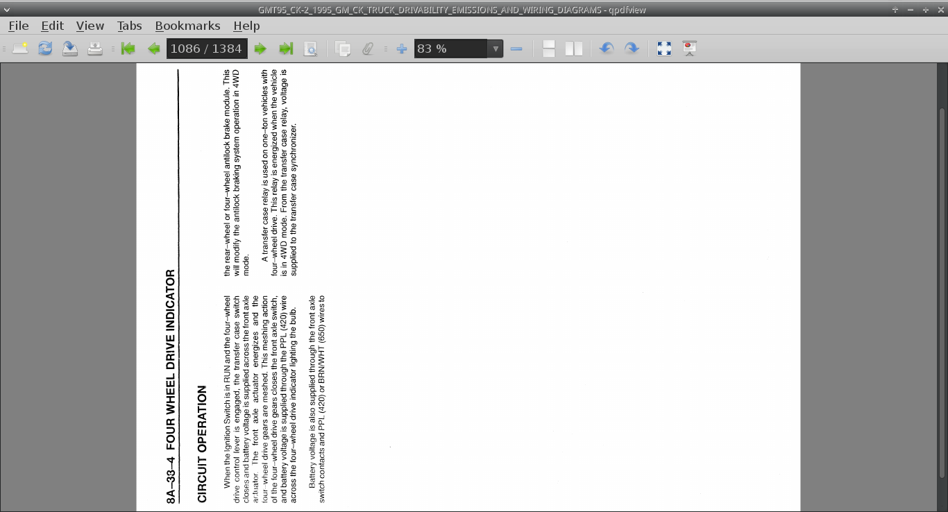

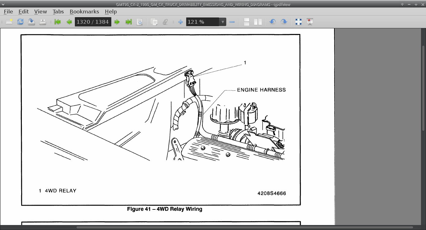

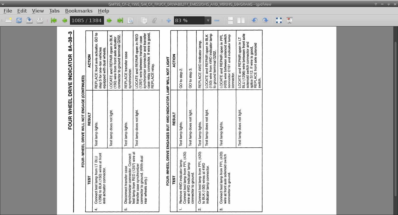

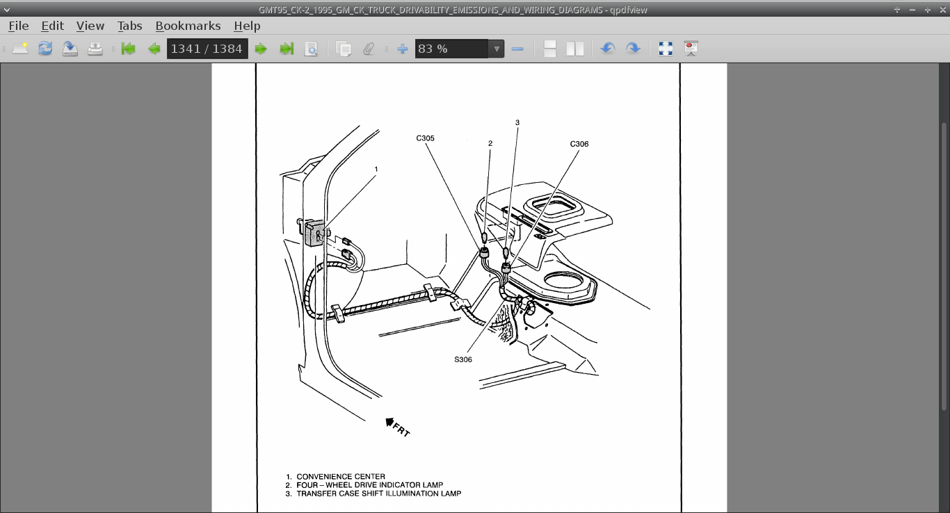

Look at these.
Screenshot1.png Screenshot2.png Screenshot3.png Screenshot4.png Screenshot5.png
