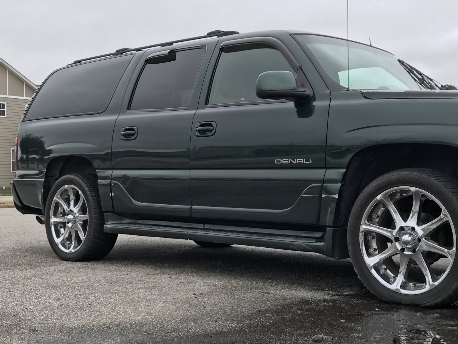

Kim Allison Ross
Mar 19, 2017
Update On My Denali;
My infamous Denali that I love and worked so hard for ****** me over Lmao.
After about a month of driving it, I noticed I had to go into higher RPMs to switch into the next gear. I had our family mechanic check it out and well the transmission is hanging on by a thread. He thinks it’s a 3-4 clutch pack failure and I agree since that’s the gears I have to go into a higher gear for. Anyways though, I know these transmission go hard but when they fail they fail. It’s literally a grenade. And although I have great insurance they deemed it unfixable and I had to sell it.
But uh here’s to a good fun month, with my baby.
Anybody have any experiences like this? Or any stories? Ig it would help me with the loss process
