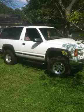

Yeah im going to run the stock wheels that on my picture xD how dos the 295 /75 16 treat you with the body lift? You wouldn't have a resent picture your you're hoe my chance would you?

Here are a few pics of my truck
ImageUploadedByTapatalk1359493400.064790.jpgImageUploadedByTapatalk1359493450.408680.jpg
