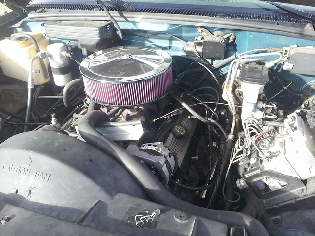

engine bay i know i have a lot of cleaning up to do
