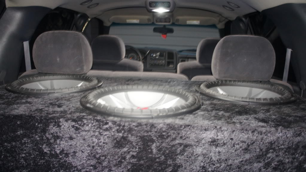

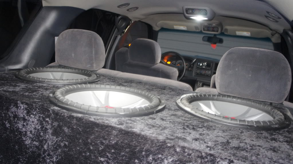

Just got the box made and installed the other day. I still think it could be louder though..

not the best but here they are.

what amp are you running on the subs?
dual 4 or dual 2?
that box looks a lil small for 3 cvr15s... the box should be 10-10.5 cubes for 3 cvr15s

9-15 cu feet is what you need for a ported box. Sealed it's 5.4-15.6 cu feet.

those numbers give you 16cft external, inside comes to 13.6cft before sub and port displacement, whats the height and length of that port

i was meaning the length of the port inside the box

something doesnt sound right about that, your box alone has a depth of 24" correct and your port height is 3" correct?

does the port turn up into the box forming an "L" shape
who made the box for you?

oh well its not that important i was just trying to see how much volume u had after displacements n such, do you have any clue what the box is tuned too

three CVR 15's will **** in the right box. Sounds like there are other issues.
Whats voltage AT the amp when your hammering it?
Is it loud to you?
we cant use Youtube videos for us to edit or modify how your system works.

also, what 3000 watt amp?
