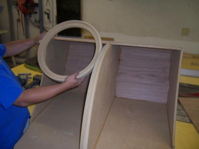

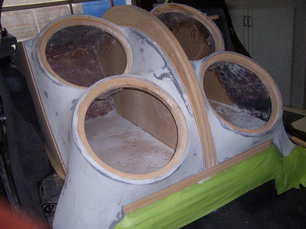

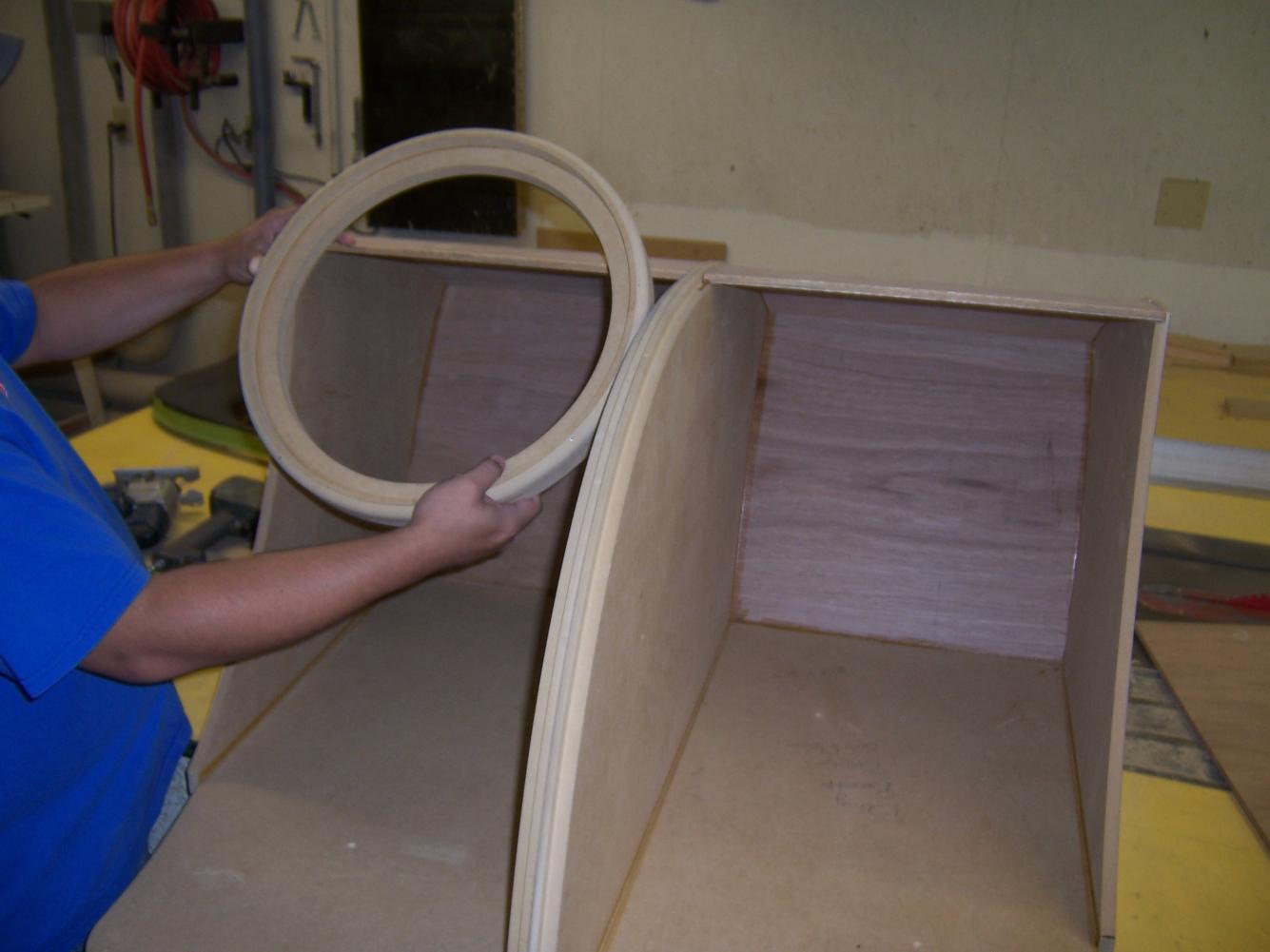

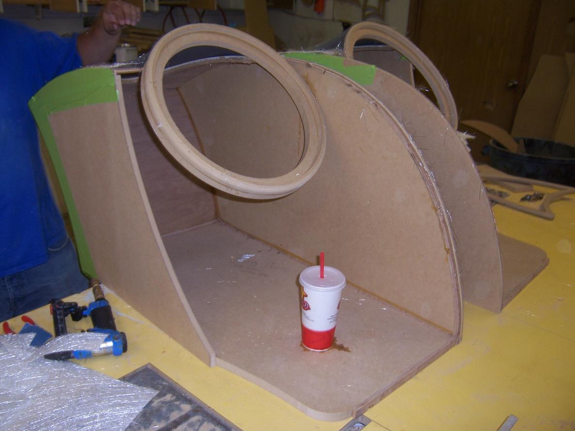

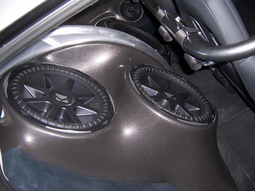

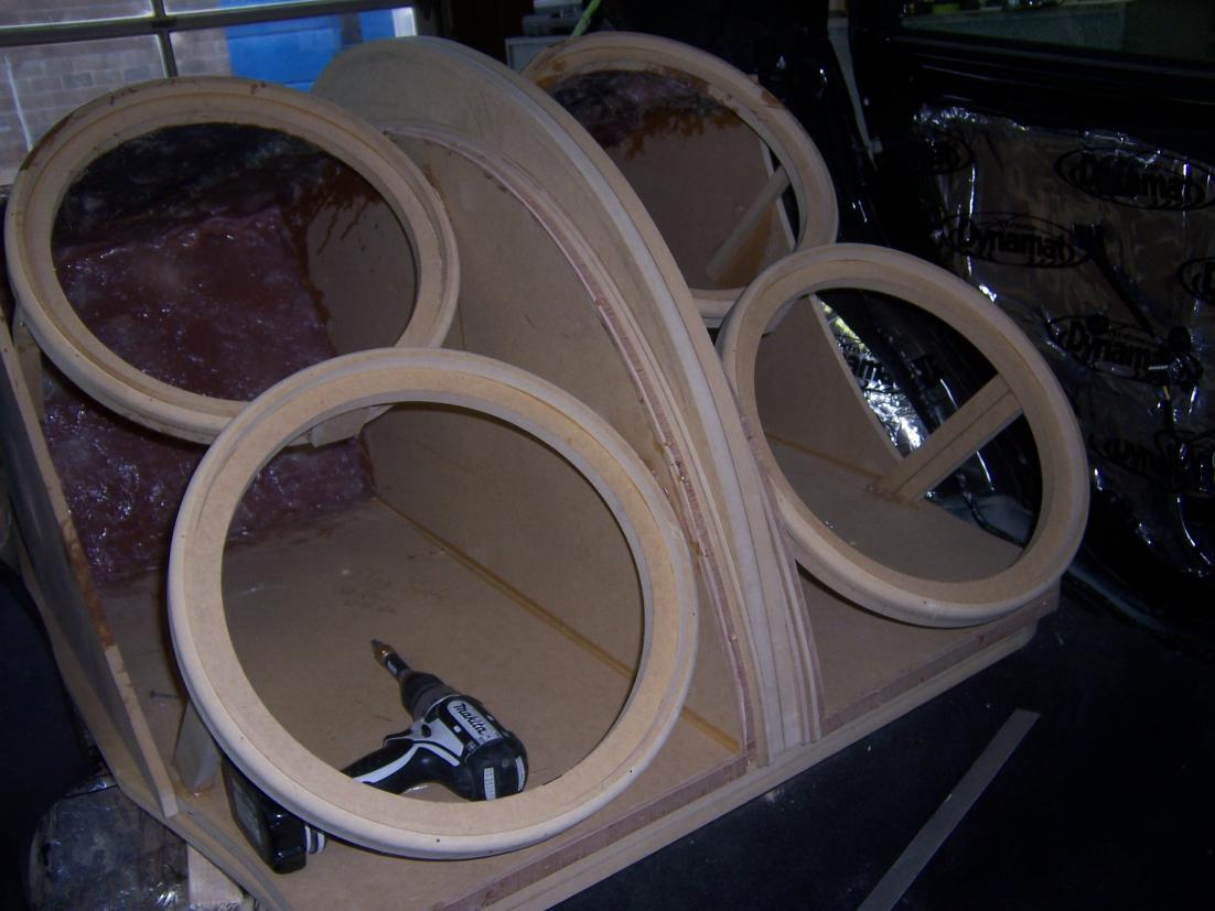

you really dont need that much space. We just built a demo Ford Focus for SEMA, four CVR 15's off two IX1000.1 and it wanged, and four, behind the seats firing forwards. I will see if I cna find some pics....

pics, sealed.
