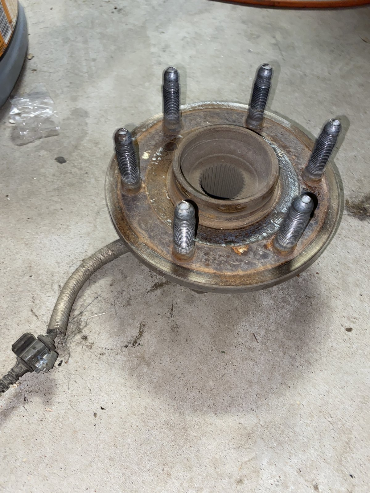

Both of mine came with 4wd hubs from the factory. Replaced with like Timken pieces recently.
View attachment 276520 View attachment 276521
That seems odd they came like that from the factory. Are you sure they arent a replacement part? Timken told me they often send only the 4wd roll-formed bearings to fleets so they don't have to worry about having two different part numbers.

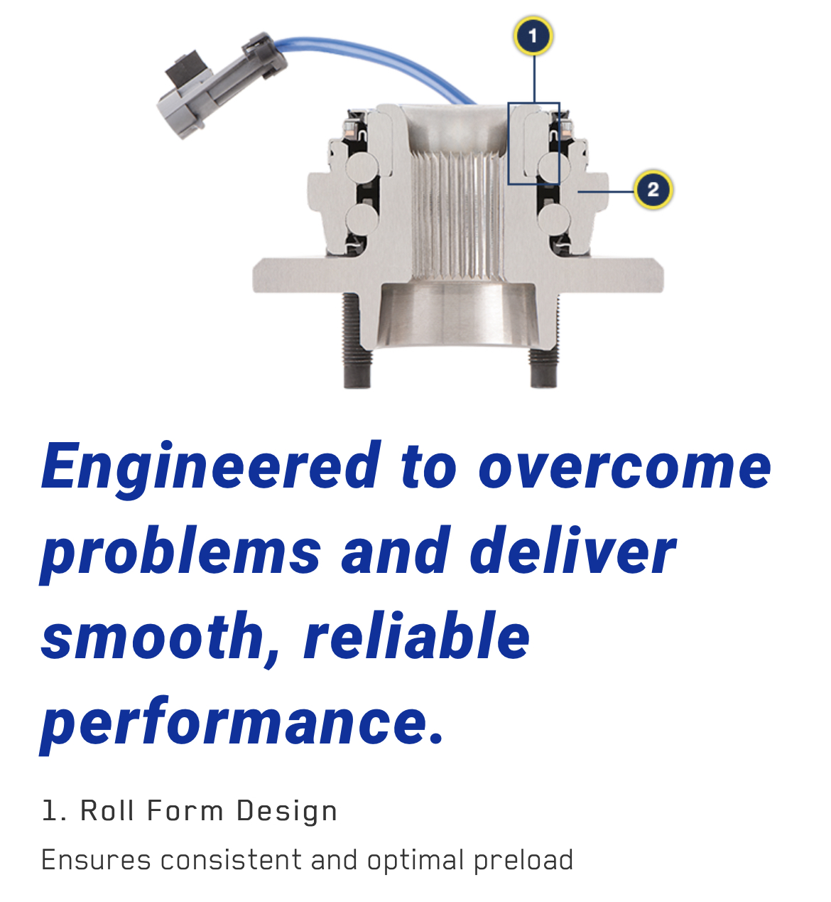

@Dantheman1540 Moogs website has a nice cross section of a hub showing that the core is a single piece and they state they use roll formed bearings. Looks good. View attachment 276522
That's a cool cross-section pic, I like Moog products and used them for some steering arms. Just gotta make sure you get their premium grade and not their economy grade replacement parts.
Not odd at all, they’re both PPVs. They even had the heat Sheilds still in place on the wheel sensor cables.
I don't know much about the PPVs I just figured they would still come from the factory with a 2wd hub if it's a 2wd. Although like Timken told me the 4x4 hubs have a slightly higher load rating which would make sense.
