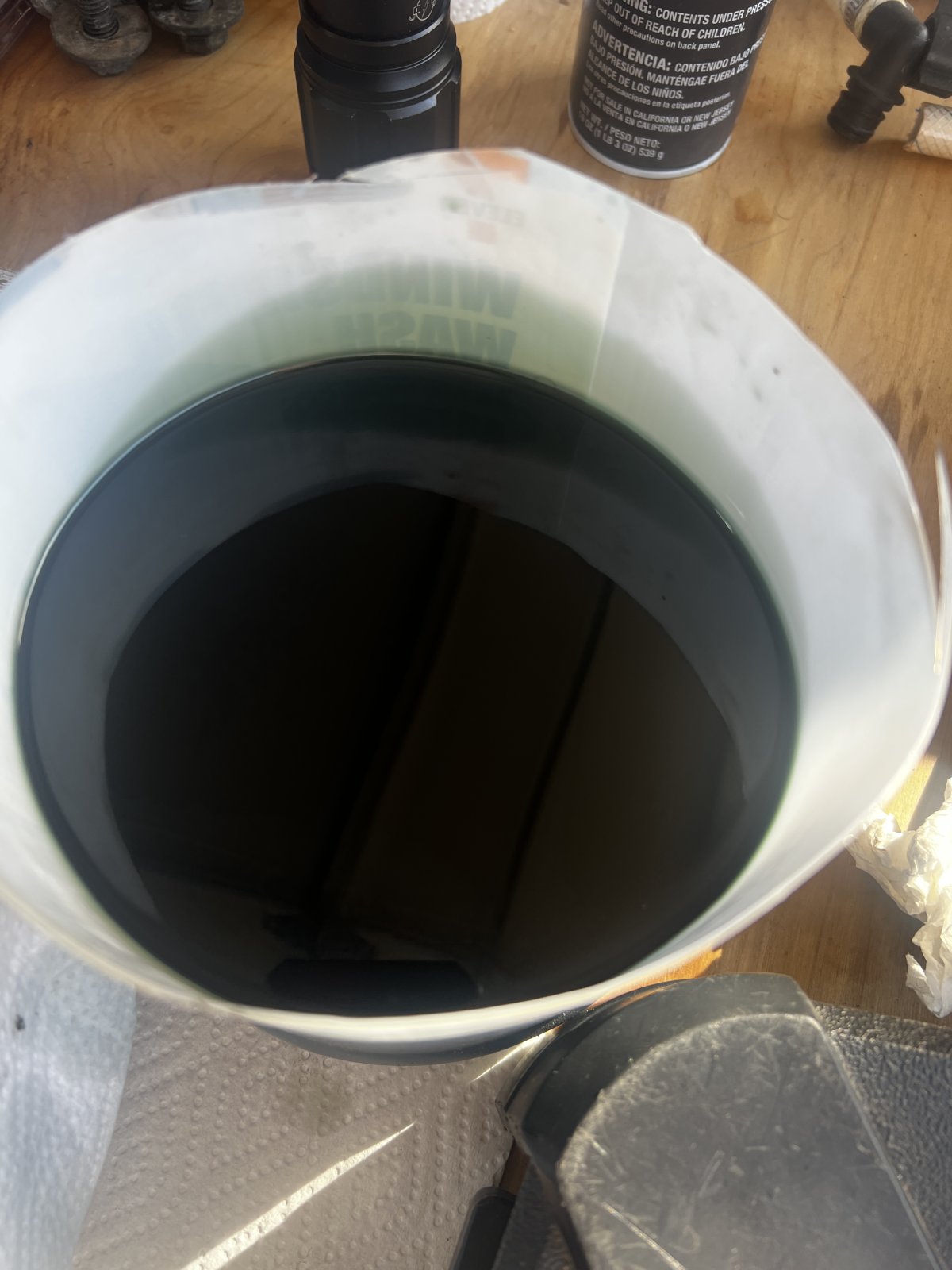

Pull the drain plug and see what a sample of fluid looks like and post a pic here. Have you ever serviced the transfer case and/or transmission?
Meathead16
Nov 26, 2022
92
84
With fluid like that you're probably looking at more than just an encoder motor..
What did the shop say?
rockola1971
Dec 29, 2016
2,862
4,084
Indiana (formerly IL)
This does not sound like a Tcase issue to me. This sounds like valves in the valve body hanging up and they are likely like that from running in extremely dirty/worn tranny fluid OR maybe even a plugged up filter.
