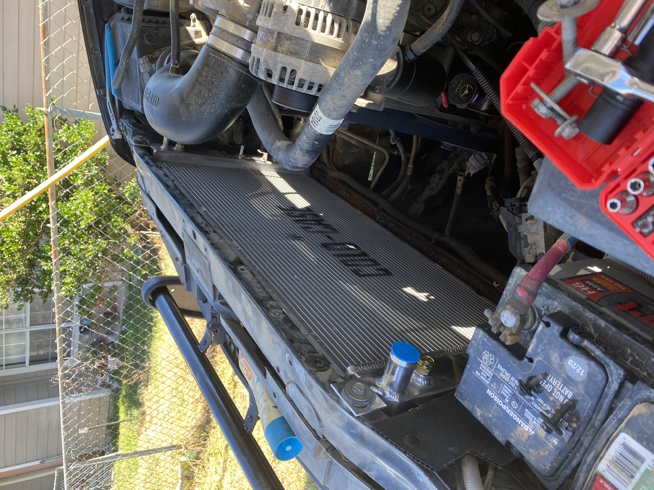

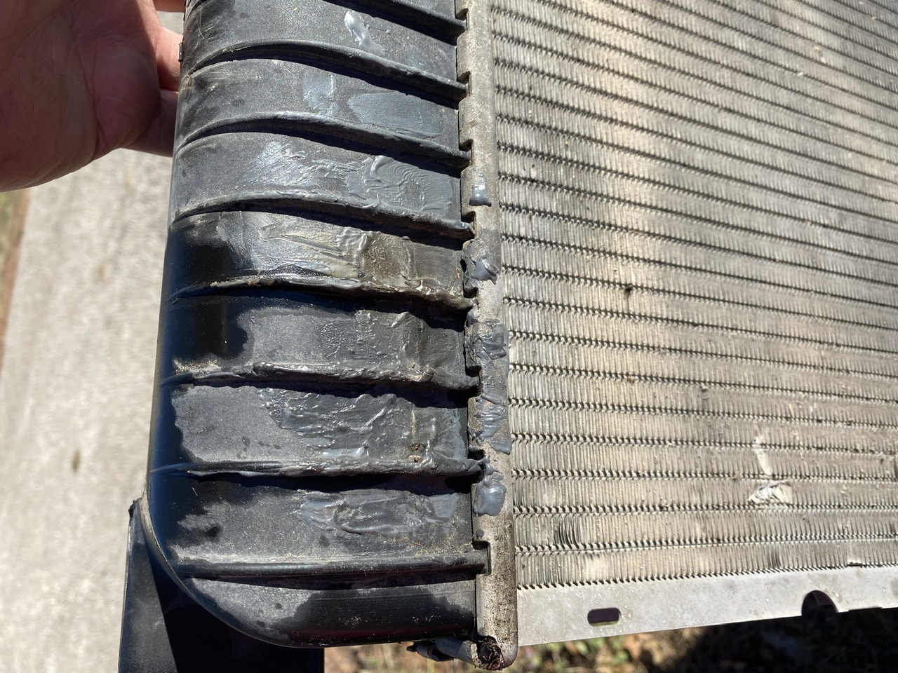

Mine let go in Big Bend, 20 miles from pavement. Same spot as yours. Fortunately I have 11 gallons of water on board and was able to nurse it back to camp. Some JB weld, and a loose pressure cap let me finish the trip and drive 450 miles home.
Summit had the Cold Case radiator at my door 2 days later.
That's a much better radiator than the one I put in, that one should last forever.
